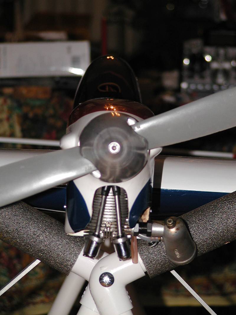

  #56
Zippi's Avatar
My Feedback: (10)
Joined: Jun 2004
Posts: 4,977
From: Evansville, IN
Default RE: *Modeltech Formula ARF 3D Competition 46-60*
Thanks for the advice flycatch. I have her all finished and ready to fire it up but thought I would post a few pics of the finisned product. I have no way to weigh the plane but I would say it's a little over 6Lbs.

Old 07-02-2005 | 02:37 PM
  #57
Zippi's Avatar
My Feedback: (10)
Joined: Jun 2004
Posts: 4,977
I ran 4 1/2 tanks of fuel through the engine and had to tweak the low end to get a good idle but other than that, the Super Tigre G90 purrs like a kitten. Even at a low idle running the APC 14X4W prop the plane will not stop from rolling. At our field we have both concrete and grass runways. I alway use the concrete for take offs and landing but with this plane I will have to use the grass to control the take offs and landings just to get it to slow down. I bought the 2!QUOT! True Turn spinner that holds the bigger APC props and the Adapter Kit I got for the ST G90 would not fit. The nut that came with the kit would not tighten all the way down onto the supplied washer. I put the stock washer on top of the prop, then the washer that came with the kit on top of that, then the adapter nut and tightened it down. I had to cut the bolt off that holds the cone in place. Didn't know what else to do, it seems fine after 4 1/2 tanks of fuel. She's heading for the blue Sky's in the morning

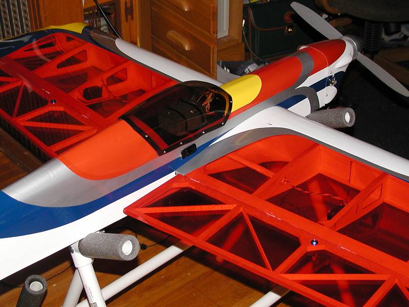

Maiden mine tonight after bring it back from vacation in Hot Springs Ark.
Buddy took it up and flew it for a little while and trimmed it in. He only did a few clicks up I believe.
He landed it and I took over.
Pretty nice flying as I spent the first flight just flying around getting used to a new plane.
Had to cut short my flights due to weather coming in.
It looks like it will be a fun flyer once I get more stick time on it.
My Setup is as follows:
The engine is a Saito 100 (yes I know overkill but it is what I had)
Jr Reciever (put this in the cockpit area)
Hitec servo's
5645's in the tail.
5625's in the wing.
645 for the rudder.
and a JR537 servo for the throttle(thinking of changing this one)
Changed out the tail skid for a Central Hobbies tail wheel as I do not like the
idea of using a tail skid.
The one complaint that my buddy had was that it is hard to tell top from bottom while flying.
I will be adding stripes to the bottom side when I have a change.
My complaints are only a few and that has to deal with the lack of a decent place to put the
servo inside the body compartment.
I ended up putting 7-9 oz's of lead into the airplane to balance it at 4.5 inches, that was the other
thing I found strange as most of the other arf's that I have built put the CG in the middle of the range
instead of at the top.
Hopefully I will get somemore stick time on this airplane this week but the weather might have me socked in
for the most part.
Here are some picks of the airplane.
John
