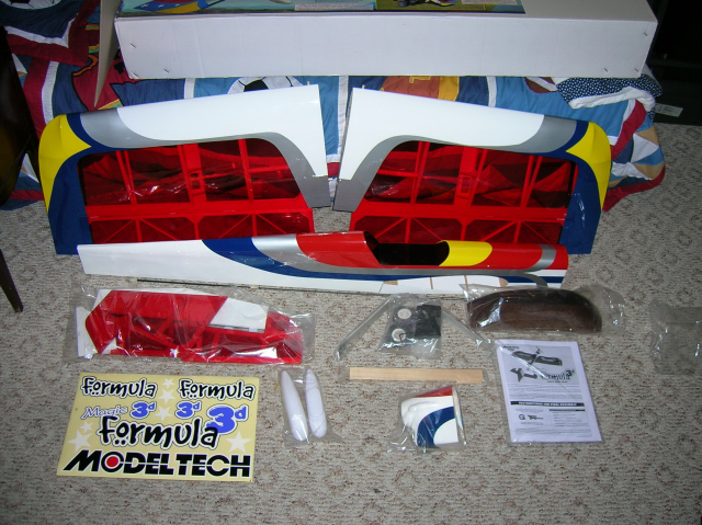

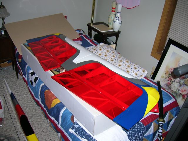

Flycatch, good to hear you got her in the air. I received mine today and all the Monokote is tight as a drum. Everything looks really good except the canopy. It is not usable. I'll have to contact Cheif Aircraft Inc. to see about getting a replacement. This thing looks really cool and it has massive barn door type control surfaces. Looks really well built to me and I'm glad to see Model Tech is now using Monokote instead of what they used before. I really like what I see and can't wait to get started on this baby. flycatch, what did you do about a tail wheel??? did you use the skid or did you put a tail wheel on???

Glad to hear your covering came out in good shape. I used the tail skid wire supplied and it works fine. All you have to do is raise the tail using down elevator if your flying from a grass field. I'm flying off a dry lake bed and don't have any problems. Happy flying.

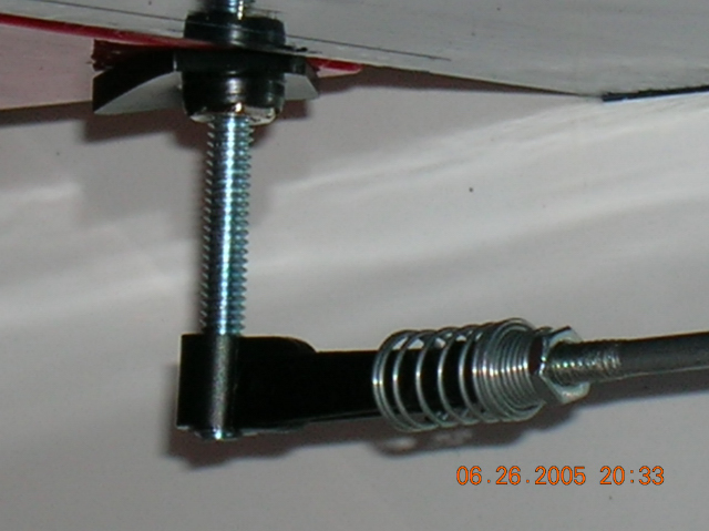

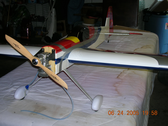

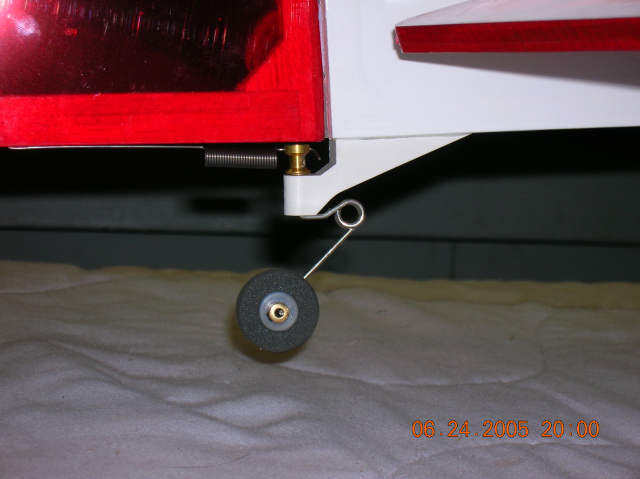

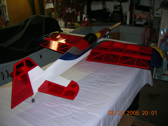

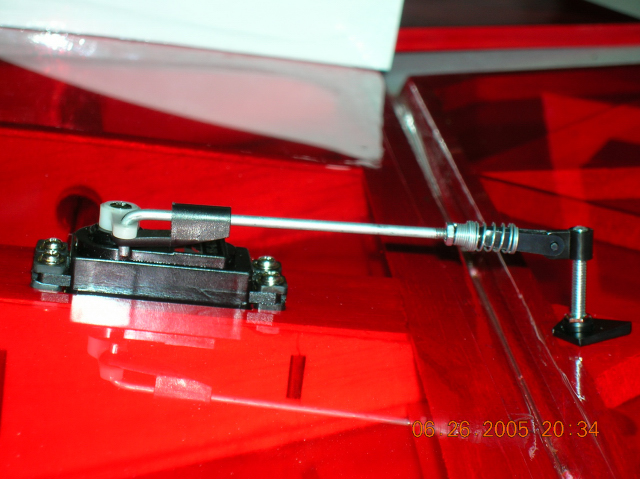

I haven't had much time to work on my new project but thought I would post some pics of what I have done. I decided to install the new Super Tigre G90 and what a perfect fit. I also added a tail wheel instead of using the tail skid that came with the kit. The cowling is trimmed out to fit the engine and all I need to do is install the easy fueler, the rest of the radio gear, and all the control rods. I'm going to use 4-40 rods on the ailerons and elevator and probably the stock rods on the rudder unless I can fit 4-40 or 2-56 rods through the guide tubes. This is a really slick looking plane. I'll post more pics when It's finished.

Like your tailwheel assemby. Instead of the metal pushrods why don't you install a cable system (Push/pull). I don't like the idea of installin a remote fueler/defuler, They have a tendency to develope air leaks and the valve stem will eventually stick in the open postion.

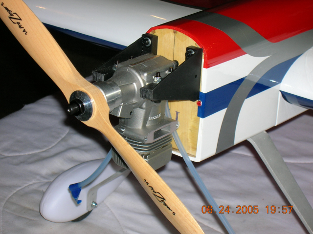

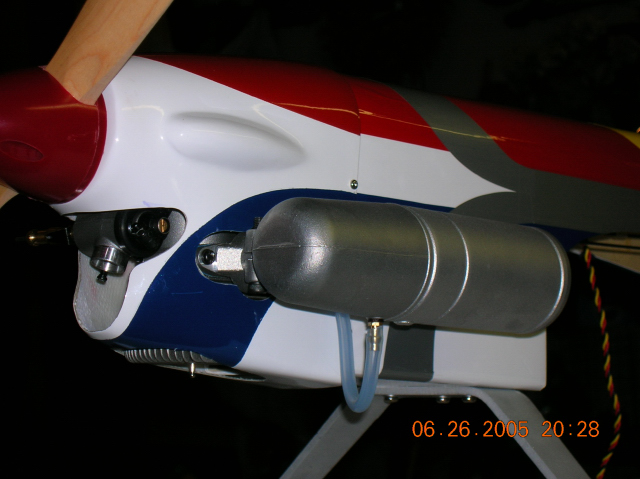

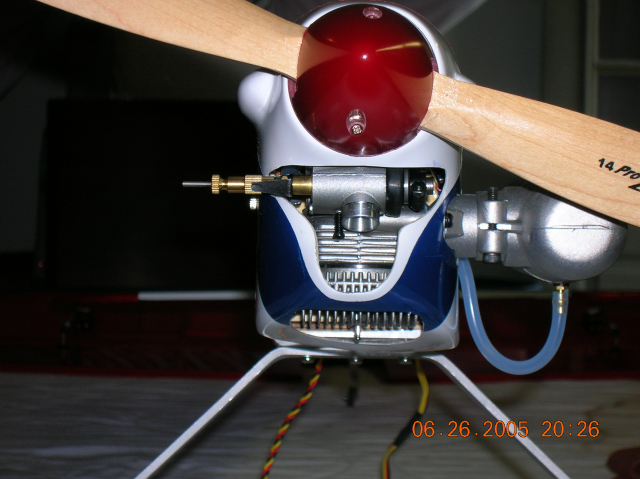

When I installed the engine it created a nice smile on the plane, Looks like the Jokers smile I used Dubro Adjustable Control Horn instead of the stock ones and all 4-40 rods. The only thing else I didn't change was the rods for the rudder. This looked ok to use for the rudder. I had a hell of a time getting that 2" spinner to go over a 14X5 Pro Zinger prop. I had to chop it up a lot to get it to fit. I don't know of anyone that makes a small spinner to hold big props. Someone needs to come up with some of these as now a days almost all planes are being over powered.

Looks great. The nose looks very aggressive. Tru-Turn has just released spinner assemblies that will accomodate the APC propellors. Let us no how the .90 pulls this plane in the vertical.
Word of caution! Be aware of the increase in torque. I almost forgot to mention that I believe the propellor you selected is of the wrong diameter for the engine. Instead of the 14 go to a 16.

That's the only prop I have on hand now, I have ordered some 15X4 props to see how well they work. A read hear at RC Universe that the 15X4 was good for 3D on the ST G90. Do you know of anyone that is running the ST G90 for 3D and what prop they are using???
