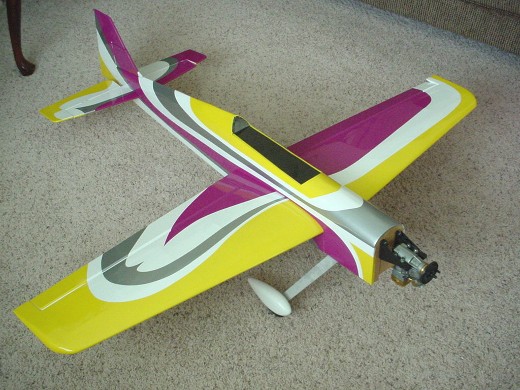

Old 05-25-2005 | 04:04 PM
Joined: Feb 2003
Posts: 513
From: Kennewick, WA
Default RE: modeltech twist
I ordered mine back in Feb. and just found out that it should be here any day.
I've got the engine and radio gear sitting here ready to be installed.
It looks like it was a joint design with YT International, and Global, and from what I've heard it should be great, especially if YT had a hand in it.
I'll keep you guys updated.

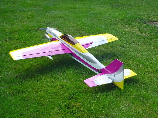

Old 05-30-2005 | 05:02 PM
Joined: Feb 2003
Posts: 513
From: Kennewick, WA
Well, so far... O.K.
This is my second Modeltech plane, and they still can't figure out how to line up blind nuts and wing hold down bolts(maybe I just get bad ones). I had to lengthen the holes toward the LE about 1/4" to get them to line up.
I was stuck on instruction number one until I figured out that the holes for the servo leads to exit are not where they say they are. I didn't want to hack up the covering trying to find it.
Then to attach the belly pan to the wing, they say to use silicone sealant. First time I've ever seen that. I'd rather use epoxy, but I used the silicone, and we'll see how it holds.
I am impressed with the wing joiner. I'm used to the little 6-8" ones. This one is 12" long
The rest of the build should go pretty smooth, and I hope to get it up this weekend.
It will have a K&B .48
I think your 82 would be great if it will fit in the cowl. I know a couple guys that have 82's in their Twist's.

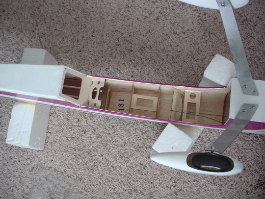

Well, thing are going well, now that I finally got some time to work on the plane.
All control surfaces are installed with CA hinges, gear is on with wheel pants, engine installed, and now I'm getting ready to start puting in the radio gear.
The firewall has right thrust built in to it.
Blind nuts for the main gear lined up nicely.
Only minor problem so far, is the wood backing pieces that glue inside the wheel pants don't fit in the little reced spot for them, but I got it to work.
ID:	279652   Click image for larger version
ID:	279653   Click image for larger version
Old 06-04-2005 | 04:00 PM

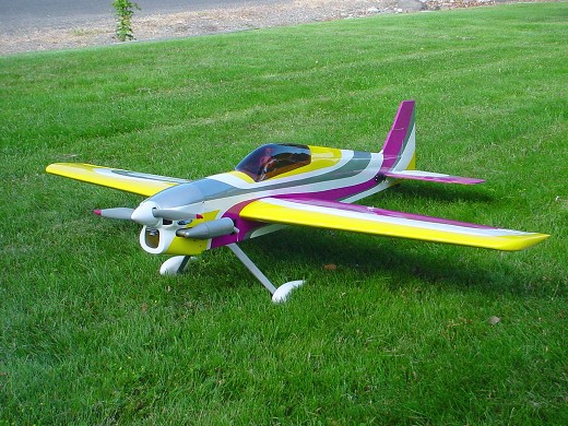

Well, here she is. From what i can tell on my scale it looks like about 5-5.5 lbs.
Now I just need to break-in the engine, then see how she flies.
ID:	282617   Click image for larger version
