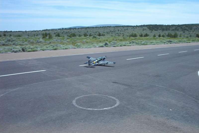

I didn't bend the gear at all. I just installed them as per the instructions and have not had any problems with nose over at all. I also installed a super tiger 61 as per the instructions. Flys awsome and lands so slow with full flaps...

Thanks scaleman, my fist flight will be wednesday, your flying site looks fantastic and so does the stuka on the runway!!!!!!!!
