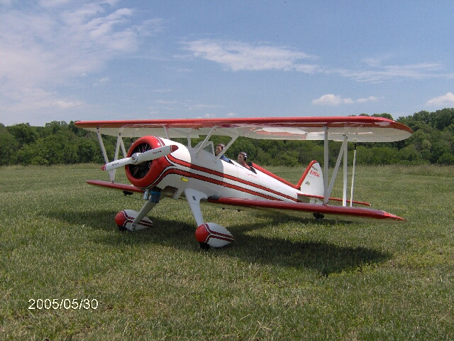

I just finished mine a few days ago and got about 5 flights on her now. She's a beauty in the air and on the ground, but you will need rudder. On mine the adverse yaw from the ailerons is pretty noticable if you forget the rudder, it's not bad but really easy to see. Her she is right before her maiden with no spinner since I needed to cut it out for the prop and had not done it yet

The prop is a Biela 18X6 on a RCIgnitions Converted G26 Zenoah. Needed no extra weight and it has yet to see anything above half throttle. Smoke system is ready for install. This bird just screams for smoke
The prop is available from here. It's a wide blade prop. I usually use a Mejzlik 18X6 on that engine but I wanted "the look" and this prop dropped rpm by 400 but it really did not take away from flying the plane.
