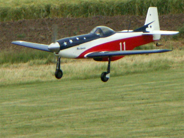

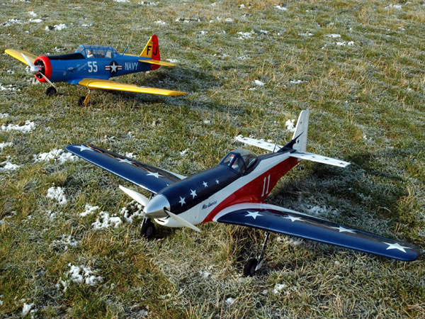

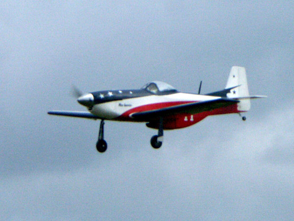

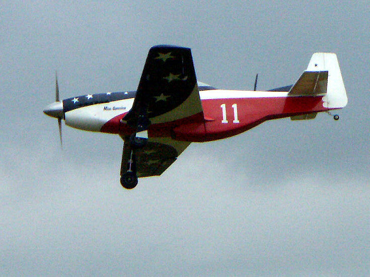

yep, no problem with mine either,..;straight ailerons
