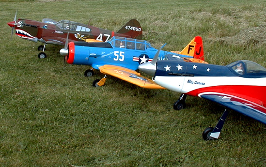

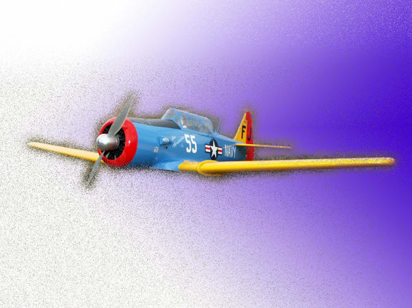

well, I have it with flaperons (small movement, about 5mm) and yes it helps slowing it down and decreasing the take off length, and no it does not hamper the plane flight characteristics.
one thing is theory, the other is practice....I do it (as well as on my P-51 MA and P-40) and yes, it helps.
What I avoid, is putting too much deflection, that's all
