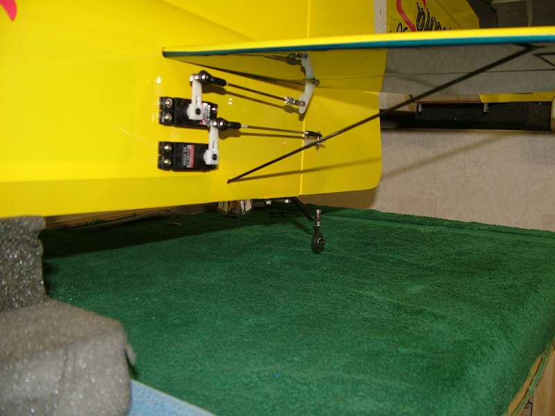

I went the lite ply and blind nut method. Works well. This is an Ohio Products tail wheel assembly. The photo does not show the tiller arm I added to the rudder.
