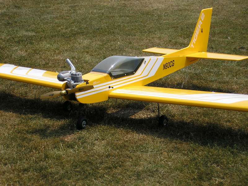

Old 06-27-2005 | 07:06 PM
Joined: May 2004
Posts: 343
From: Reading, PA
Default RE: Goldberg Tiger 2 ARF
Add me to the list of Tiger 2 advocates! Just maidened mine with an OS 46FX and it was a dream to fly once I got the pitch sensitivity dialed down. After that it practically landed itself. Mine came already built (a friend's dad was getting out of the hobby, and it was given to me already built, ready to fly). One thing you have to be careful of, check the c/g carefully! Mine kept tipping back on the tail when the tank was empty. I put several ounces of lead under the engine and it was still tail heavy! Finally used a "heavy hub' instead of a spinner, and it balanced perfectly then. Maiden flight was yesterday and it really is nice to fly, for all the reasons already stated above. I don't think you'd regret getting one! good luck! Picture of mine is attached.

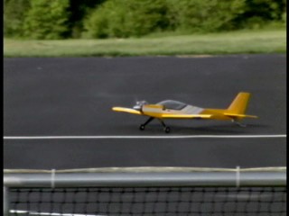

Old 06-27-2005 | 11:58 PM
shakes268's Avatar
Joined: Jan 2005
Posts: 1,320
From: Fairview, TN
Definitely buy this plane! Attached is a pic of mine as a tail dragger.
It's so much fun to fly!
