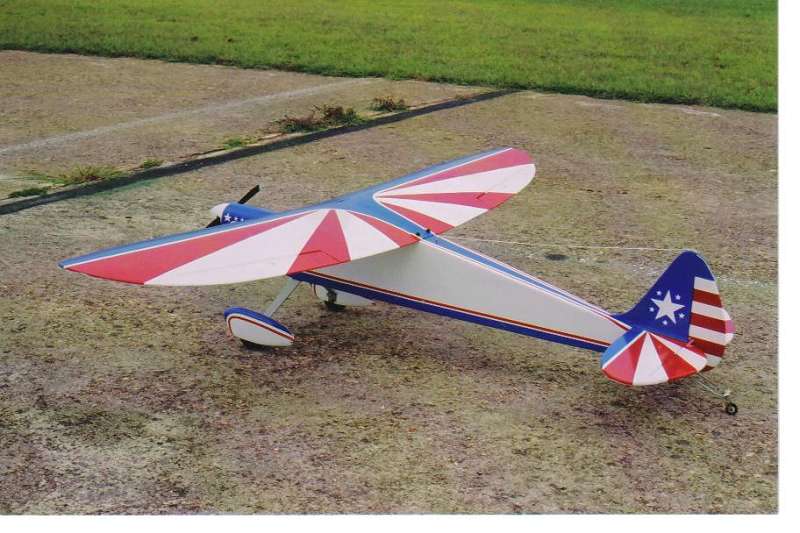

You got that right! Like Tim, I have a 4-stroke in mine, but Sig must have thoght it would be okay for either engine, I can't see them locking the buyer into one type (or size) of engine. There's a lot been said about inverted mounting of 2- and 4- strokes, but from my experiences with inverted 4- strokes (I have three, all Saito) if they are set up properly, and you follow a few simple practices, no problems. The biggest negative I read about is cylinder flooding, but if you keep the carb completely closed when the engine is not running, it shouldn't be a problem. Next is poor idle performance, it hasn't been an issue on my Saitos, I can't speak for 2-strokes, but there are guys in my club with inverted 2-strokes, and I don't hear them complain or see problems with their planes.
I suppose if you wanted to, you could cut the front end off the Rascal at the firewall, and mount the engine sideways, then fashion some sort of cowl, or use the piece you cut off. The engine mount has right thrust built in, so you'd have to duplicate that with whatever mount you used.
I love my Rascal, it's my "daily driver". I wish Sig would make it in kit form, in a size about half way between the 40 and the 110, wingspan about 85 inches, use a .65-.90 engine
