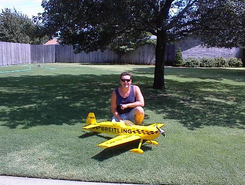

Old 10-22-2002 | 09:02 PM
Posts: 254
From: Weatherford, OK
Default Which engine for Kangke Cap 232 ???
What he said. I have standard bb 43 oz. for ailerons and 605's on pull pull rudder and arrow shaft elevator.
I'm trying to find the instructions for recommended cg. All I have is a couple of sharpie dots on the fuse. It only takes a tad of elevator inverted so I imagine it's close.

Hey Cabane, what are you doing with my plane Daz...

I just recieved mine today, and checked the instructions for the CG. It says the limits of the CG are 3" and 3.5" from the leading edge.
Later in the manual under "Advanced Flight Trim", it says for CG fine tuning, "roll inverted, neutral elevator to two clicks of down trim. If the model descends, move the CG aft. If the model climbs move the CG forward. CG movement should be no more than 1/4 inch at a time." I'm not sure if that means that you can go outside of the 3" to 3.5" limits or not.

Kangke is known for consertive C.G. locations.
They use 26-27% of the MAC. Its a good place for the test flights, but over time you'll move it back.
DKflyer, I followed that advanced trim section and can tell you it works. In fact save it cause it works on any plane. :^)
