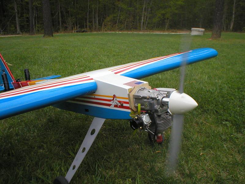

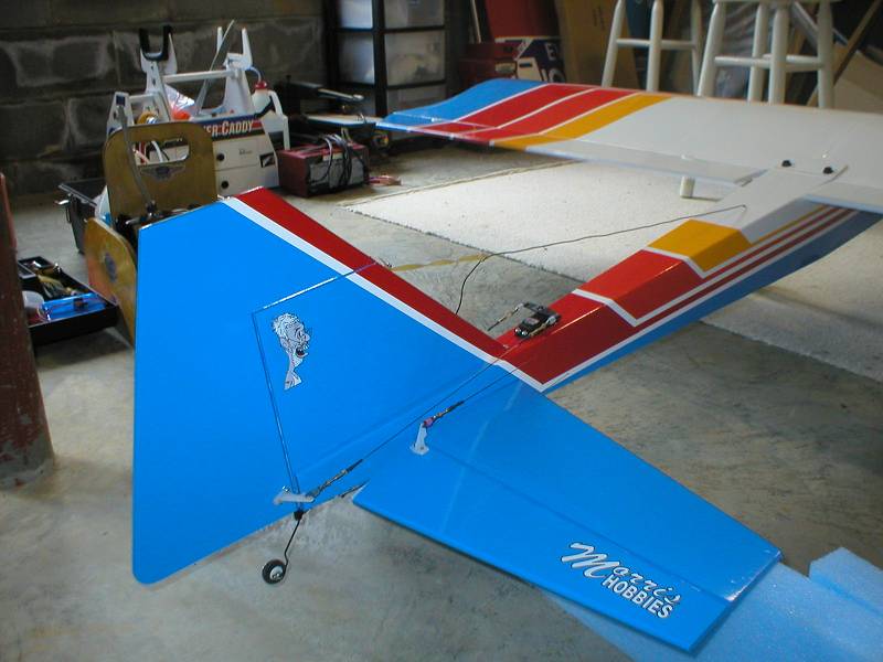

Howdy. I love my big boy with the G26. It is a bit heavy so I mounted the rudder servo in the rear and also put the battery back there. With a 16X8 APC prop it will not roll over ten feet before it's airborne. And even at $2.25 a gallon, it's a lot cheaper to fly. I'm using Hitec HS 475s on the wing, HS 635s for elevators, and HS 645 MG for the rudder. A 2000mah Nimh battery. This plane is really flies great and lands about as slow as you can walk. I used all the hardware that came with it. It was my first attempt at pull-pull and it wasn't hard at all. Here's a few pics of mine. You WILL NOT be disappointed, I promise.

If you decide on the G26, you can make things a little easier on yourself when mounting the fuel tank by going ahead and cutting in a hatch on the top of the fuse behind the firewall. I fought it for awhile and my tubing kept getting crimped and so I laid it out and used a hobby knife to cut it out. Glue in some scrap balsa to lay the hatch on and use small screws to hold it down. Quite simple really. I did it to all my US 120s.

Haven't checked in for couple days. It is very thin in the tail making istallation of the servos very tight. That's why I went ahead and used the pull pull for the elevators. I don't have any trouble at all with the elevator control. I clamped a short piece of yard stick on the stab of each elevator to keep it lined up. I centered the servos using the radio. Then I adjusted the control rods till there wasn't any tension on them,,, or very little. The only servos that buzz (occasionaly) are the ailerons and throttle.
