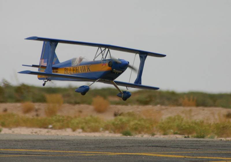

Balance it right side up. As far a CG its best to fly it were in the foward CG point. After you can move it back a bit at a time but there's a fine line between love and hate. I've been flying them for years and love tem. Mike

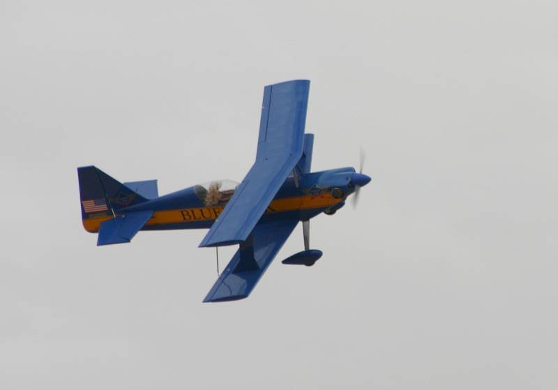

Your right Its a darn good flyer. What you could try is those stick on weights by the tailwheel. Just a small amount at a time. I fly mine scale so I have about middle CG. I've found that the throws on the flying surfaces do most the work. Mike
