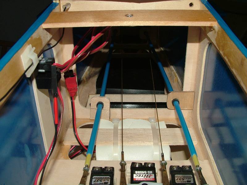

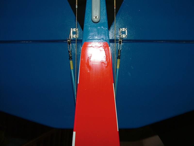

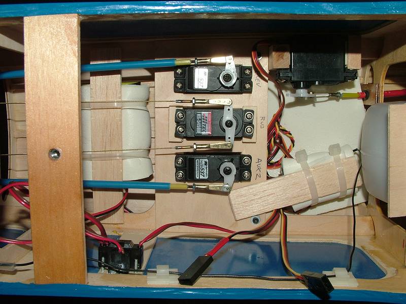

Here's my setup, you will need to make braces for the pushrods in the fuse, you can do it all by removing the covering from the bottom of the plane. I'm using the sullivan semi-flex rods, and you need the braces to keep them from flexing, I just put a brace at every fuse former. This setup works very well and I have no slop in the linkages, you can see I moved the throttle servo forward of the stock servo mounts and used the outermost stock mounting holes for the two elevator servos.

My Feedback: (46)
I also originally wanted to mount the servos in the tail, but there wasn't enough wood to mount them, unless I added some braces to the fuse side. I didn't want to cut the covering on the sides but didn't mind the bottom.
I wasn't able to get the split pushrod to give me even deflection on both sides. I also didn't like the amount of slop and springee feeling you get with the split pushrod.
I also lost one elevator side due to flutter in my first kit built ultimate which is why I decided to come up with something better for my ARF version.
I did have to add weight to the tail, I think it ended up being less than two ounces. I think my YS 1.20 is pretty much overkill this is not meant to be a fast flying airplane, and I never usually get above 1/2 throttle unless I want to accelerate going strait up (which looks pretty cool) IF I was to do it again I would put in something smaller and lighter (engine) so I wouldn't have to add weight to the tail and I could use my throttle above 1/3-1/2.

The reason most folks who have trouble with elevator differential on this type of installation is because they don't realize that a split pushrod which is not centered in the fuse at the servo automatically induces a bit of differential. The manual tells you to use one of the side slots for the elevator servo, reserving the center one for the rudder servo so the pull-pull will be centered. Assuming the elevator pushrod is even on both sides, a quick look at the geometry will show that, with a non-centered servo, one side of the split pushrod is moving farther than the other; instant differential. One can tweak and bend the pushrod to eliminate this, but it is a tedious trial-and-effect exercise. It was easier for me just to make an alternate set-up and glue that puppy in place, so i could center the elevator servo.

Well, I've done it both ways. I had to fabricate a two servo elevator installation in a Goldberg Matrix when that bizarre through-the-fuselage bellcrank arrangement it comes with would not smooth up.
YMMV, but I find it difficult to see how building a simple bellcrank on a platform is more involved than cutting into the bottom of the fuselage, adding holes in the side of the fuselage, building sufficiently sturdy servo mounts, routing the servo wires, and closing it all back up with care so it looks halfway decent.

That's why I like the setup I used, I used the stock servo mounting holes. (with exception of the throttle which only took two blocks) I removed the covering on the bottom of the plane where it's open and was able to fit the braces inside the fuse through the existing holes. The holes for the pushrod exits are the stock holes also. My setup only cost you the pushrods and some scrap 1/8 plywood.
I just can't see using the stock setup though.

I was using a the raido to match the two elevator servos, it worked fine and I didn't want to spend the $$ on the matchboxes.
