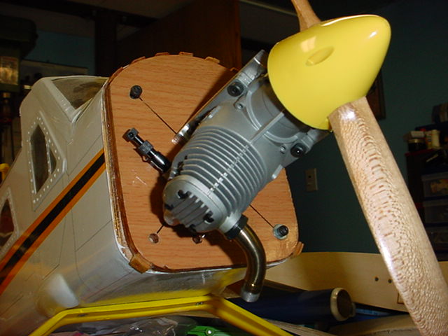

Hi Gents
I am in the process of mounting a RCV58-CD in mi GP T-6. I am mounting the engine in the 12 O'clock position and running it only with a OS flexible exhaust extension, in roughly the scale position. I find the engine very quiet running without the muffler, not to require it. The engine is smaller than an OS 40 2cycle engine and gives me about a 1/2 inch of space to pair inside the cowl, without having to cut a hole for the head. I will also use a remote glow plug adapter, and in that way I wont have any holes in the cowl at all. I also decided to mount the same engine in my 82" Beaver, and decided to mount the engine in the 7:30 position. In this way the exhaust will come straight down without the use of any fancy and EXPENSIVE plumbing (IE OS Flexible Extension OUCH!) I wish I would have thought of this with the T-6. I am posting a picture of the installation.

Otto did you have to adjust the wing saddle to make the plastic wing center section fit well?
P.J

Default Saddle ajustment and RCV engines
Hi Guys
I had to do some real fancy carving to make the center section fit, and it is still only mediocre for my taste. I am not normally a ARF builder but I wanted something to quickly mount the RCV engine in to assess for a kit candidate for the RCV flying team. To say the least the GP T-6 is no longer a candidate. I have built complete kits in less time than I have already spent on this thing, and it is still not ready. Do your self a favor and buy your self the CMP T-6 when it is ready at the end of this month. (I AM) To properly install the retracts you should not use the wing buckets, and you should replace the kit wheels with something softer to prevent landing damage.
