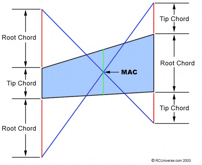

Another thing occurs to me. What about wings that are not constant cord? Where is the CG at the wing tip? If the LE is straight, I suspect that it would not change, but a swept wing would change, would it not? What do you think?

garcay, There is a formula for figuring out where a wing should balance.

excellent, thank you!! I am an architect and in structural enginnering we refer to this as the geometric center of a given area. Or so it would appear.

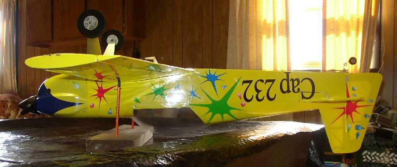

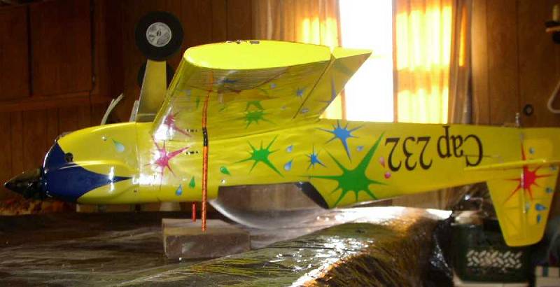

OK I figured I'ld include my version of a plane balancer, all you need is a 2x6, a couple un sharpened pencils, and to drill a couple holes.
But now I have a question. I just finished putting the plane in the pics together and checked the balance. The instructions say that it should balance anywhere from 3.75" to 4.33" back from the leading edge. Mine balances right at the front mark of 3.75". After the first flight yesterday, it seemed like it wasnt real steady flying, controls were sensitive, wouldn't level itself out. I've heard that if the planes balanced to far forward or rearward, that it will not fly very good. Can someone please tell us how this works. ie .. balance toward the front mark and it's more stable, or towards the rear mark and its more stable???? I always tryed to balance other planes in the middle of the 2 marks, but this plane is perfect without no weight at the front mark, so I left it alone.
NOTE: This is my first aerobatic plane, have had high wings before this. How will this plane handle differently then the high wings??
Thanks.

Ok, first off, balance towards the front of the range means it's on the nose heavy side, so it will be more stable - toward the back means it's on the tail heavy side, so it will be more sensitive.
Regardless of where you have it balanced, you will find a CAP to be EXTREMELY sensitive compared to most High Wing planes

Airplanes with a symmetrical airfoil and a low wing like your CAP are not self leveling like a high wing. They will go exactly where you point them and if you let go of the sticks the airplane will follow it's present course all the way to the ground. That is why they are good aerobatic airplanes; they do exactly what the pilot commands and nothing the pilot didn't command. If you are looking for high-wing-like stability in a CAP, you won't find it.
Still, you should be able to get comfortable with the way the CAP flies. The first thing you should do is reduce the elevator throw by 50%. You may also want to reduce the aileron throw. That will make the airplane much more docile. As you get used to the plane you can increase them again. Leave the CG at the front of the range for now. Moving it back will make the elevator more sensitive.

Mike and Jim,
Thanks for your input, it helps alot. I will leave the plane balanced like it is. The first thing I did when I got back from flying it was to reduce the throws on the elevator and rudder. The ailerons only have 3/8" throw to begin with, so I think they are fine. I guess it will just take some flying to get used to it, and I hope I get plenty of flying on it. Have a good one.
