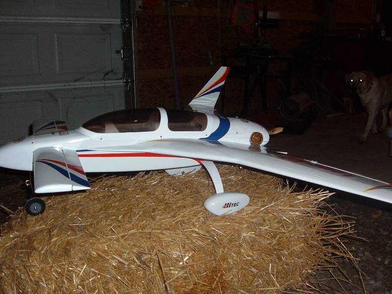

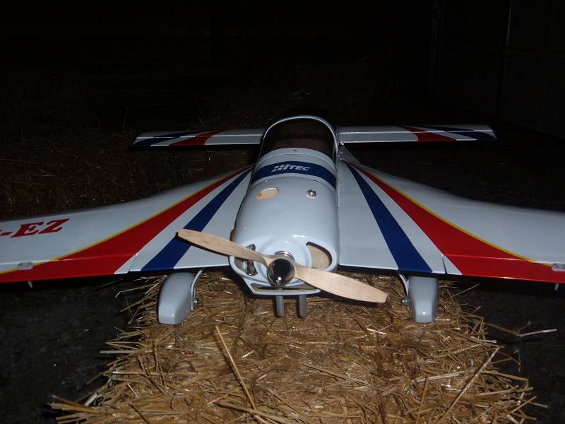

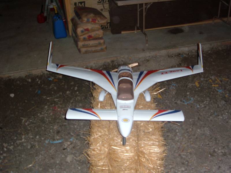

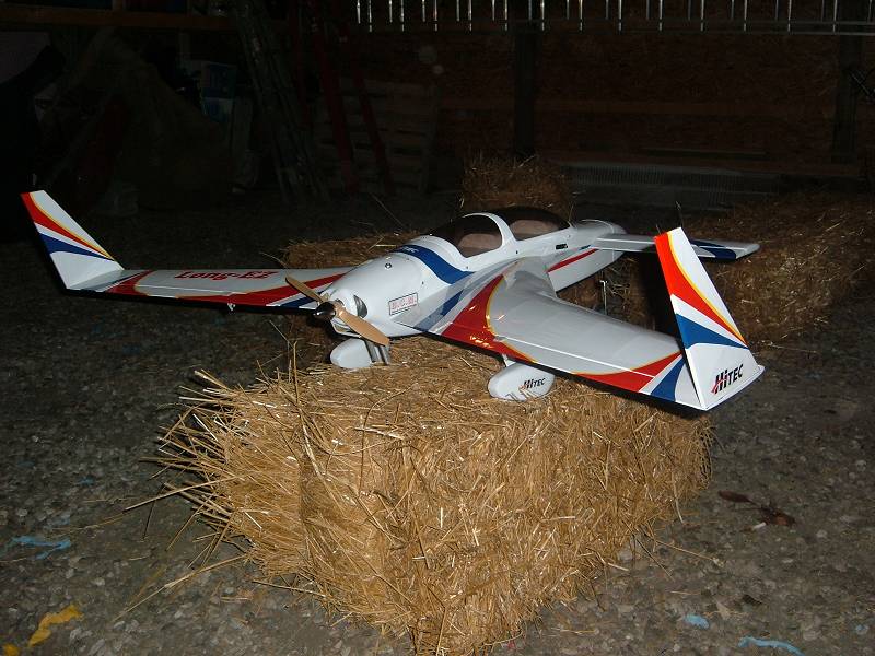

Well I finished it tonight. I am not happy with some of my work but oh well.[>:][>:] I hope I can fly it. All I have left to do is CG it. Thanks for all the info this thread has been very helpful. I have 2 more arfs to build. I don't think I have built an ARF with out messing it up some how but with the way I fly I will have plenty of practice.
