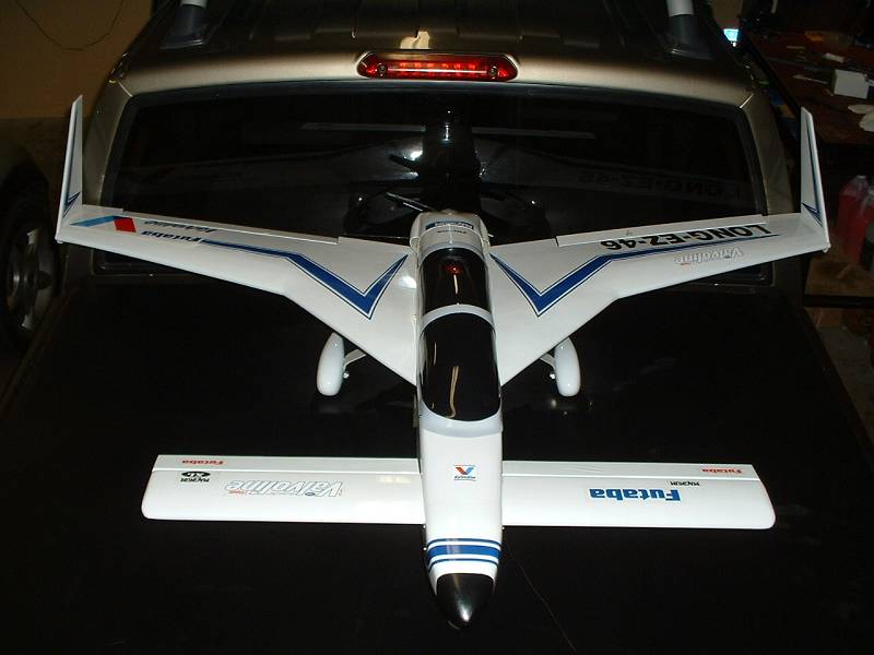

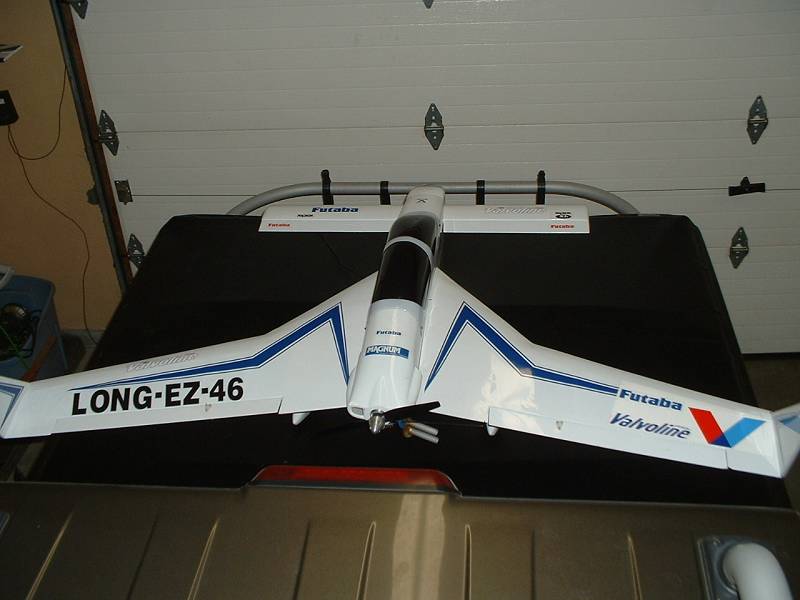

Here are some pics of the new and finished canard.

Nice looking LongEZ. Did you have the prop on backwards? Best way to tell is that the curved surface goes forward. I am using APC props so cant judge by the writing on the prop. Its a 10x6 also, and mine is quite fast. Long takeoffs are just part of the planes inheritance from the full scale LongEZ. They have a bit longer takeoff roll too. glad to hear you had a successful first flight. Aren't the rolls nice and smooth? I didnt get a chance this week to fix my retract problems so I didn't get to fly mine this weekend.

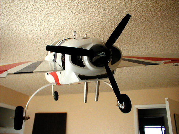

Mine's done and ready to maiden, but my usual flying field (a dry lake bed) is under water. With the long takeoff this plane seems to have, I think I'll wait for the maiden flight. My secondary flying area is much smaller.
I decided on a three blade pusher prop for appearances and to make sure the prop doesn't hit when flareing on landing.
Here's a picture of the set up.

You need to buy a "Pusher Prop" It the prop is turning the "wrong way" with the engine turned around. Puting the prop on backwards won't work very well do the the curve of the pitch in the prop.
The other solution to to using a "tractor" prop is to buy a Counter Rotating Crankshaft If it is made for you engine.
Old 01-09-2006 | 04:27 PM

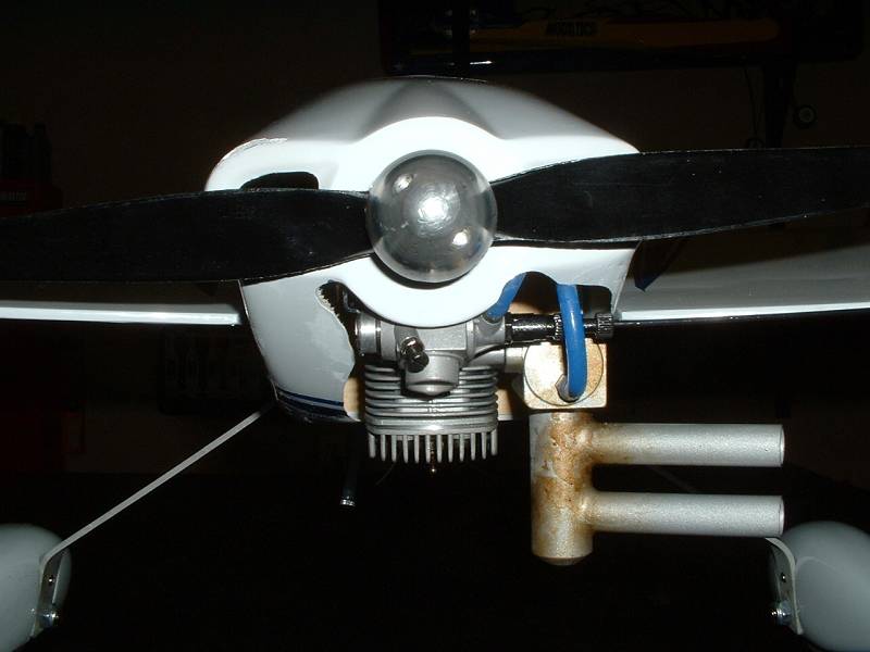

I just mounted the motor today. Did any one have trouble attaching throttle linkage. My engine is mounted like the photo in CJACKGO's post above. I have a GMS .47 with Bison Pitts muffler. I also have the rich model version. It looks like I will have to move the attachment piece on the carb 180 degrees and then bend the linkage to mate with it. Any thoughts? I have been putting this together for a while been working a lot overtime. Boy these directions are horrible.
Shayne
Old 01-09-2006 | 07:32 PM
  #73
jrf
My Feedback: (551)
Posts: 2,903
Received 5 Likes on 3 Posts
From: Burbank, CA
Default RE: RichModels Works LTC ARF's
"It looks like I will have to move the attachment piece on the carb 180 degrees and then bend the linkage to mate with it."
Yes, that's the way you have to do it.
Jim
