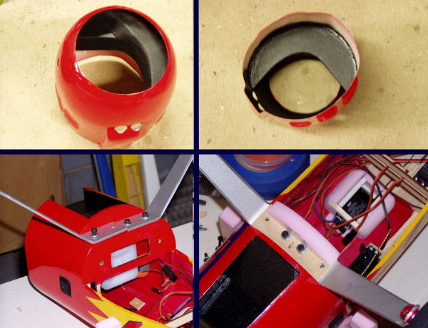

Hey, GWILLIE, that gear mount idea sounds great. I never liked big open gaping holes anyway and the original design leaves one. I was thinking about using nylon bolts, but the split gear provided sorta kills a simple retrofit. That plywood plate solves the problem nicely.
And if the sucker flies good, I plan to swipe your paintjob! Already pulled a copy of the pictures.... chuckle.... I was figuring that the thing was really going to look the same top and bottom and something might need to be done if only for that. Thanks for the good ideas.

And here is a picture of the modification I'm making using GWILLIE's idea. The pink foam is going to be glued to the plywood and then fuelproofed. It'll fill the void the gear attachment makes right behind the lower firewall. I'm guessing that the improved aerodynamics ought to give the a/c maybe 30 or 40mph more top end....
at least.... chuckle
Oh, the other two pictures in the group are of the cowl "stuffing". You can see from the front pix how round it's become and from the rear pix a hint of how warped it was overall. The out-of-shape at the rear is pulled out by the fuse.
at least.... chuckleOh, the other two pictures in the group are of the cowl "stuffing". You can see from the front pix how round it's become and from the rear pix a hint of how warped it was overall. The out-of-shape at the rear is pulled out by the fuse.
