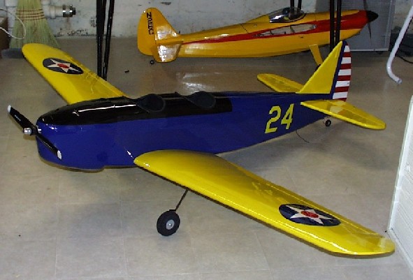

Built and test flew a friend's GP PT19 powered w/ an OS120 Surpass, which is a very good match IMO.
I think the plane has sufficient eing area to handle the G23's weight, though you might have to move the servos to the tail for balance.
Oh, by the way; we found the CG listed in the manual to be approx. 3/4" TOO FAR BACK, so beware!
It's great looking plane - perfect for a relaxing Sunday at the field.
Here it is in flight.

Old 11-06-2002 | 04:36 AM
LuvBipes's Avatar
Posts: 1,252
From: Gainesville, FL
Default OOPS!
Trying again....
