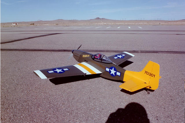

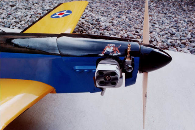

I run a ST G90 in my little .40 size WM P51 with a Pitts underneath. Now, I run it sideways. When you look at this you will come with the fact you cannot get the cowl over the engine??? I remove the head on mine to get the cowl on or off. No real problem. I get a respectable 100mph out of mine here at 5000ft. A guy here runs a 61fx in his Dago Red and he is right on my butt.

>>Cyclic Hardover
Thanks for the info. Does the cowl have to be removed to tune the engine? If so, the head has to be pulled each time? 100mph+!!!! WOW!!! I am at about the same alt. as you, 5400ft.

Not at all You should be able to carve the cowl to make everything accesible. I am going to try and find an old shot from last summer here before I recovered
The guy with the 61fx runs an 11/8 apc
I run my G90 with a 12/10 or 12/9 apc-I get around 10300rpm
