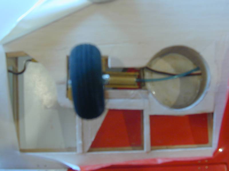

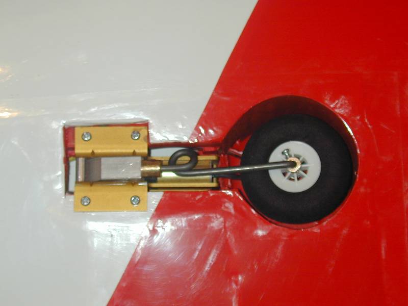

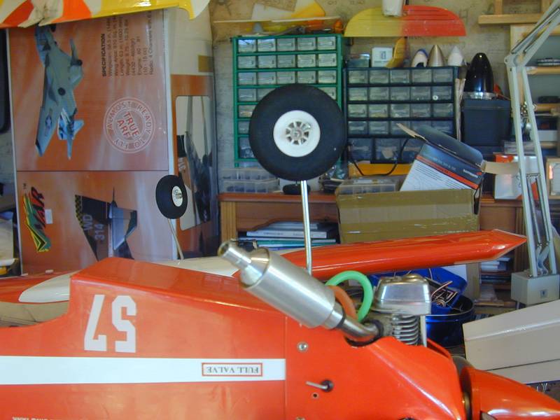

Ok guys
The original wheel position in the wing is too far back for good take offs from grass, therefor first decision is to move the undercarridge forward (see pic) this will entail abandoning the original bearers and installing all new, Second decision the nose wheel is too long to fit in the bay in front of the wing, this will entail shortning the leg and reducing the ground clearance at the moment there is 2 1/2" of clearance with a 12" prop so this should be feasable. next installment what retracts pneumatic (space problem) mechanical (two servos, third for stearing?). will start to cut soon.
Mike

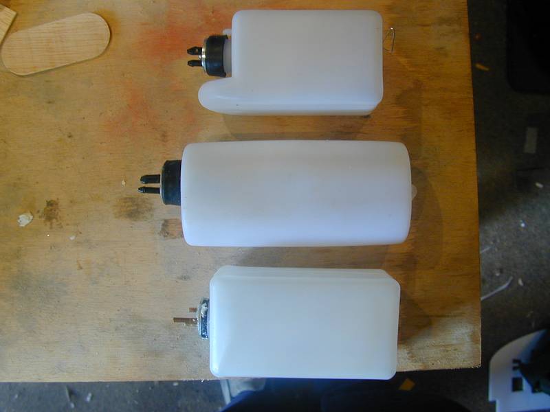

Default RE: Retractable undercarridge instalation in a RTF
I've seen installations with three gear hooked to one retract servo--not easy to setup, but it is possible. The steering will get you, though. I don't see anyway around a separate servo for that--pull pull is the only way I know of around it. I've not setup trike retracts, but I've done some main gear retracts--both pneumatic and mechanical. Pneumatic is definitely the easiest to setup, IMO, but you have to have room for the tank, and valve. This is sometimes difficult to find, but that looks like a fairly thick wing--put the airtank in the wing! If it isn't a scale plane (I don't know anything about the plane at hand), then I'd definitely change it to a tail dragger and be done with it!

2slow2matter
thanks for your input, the only air tanks i have or can find are about 1 3/8" in dia, this is thicker than the wing and bigger than the space between the servo tray and the underside of the wing, I must admit that I prefer air up spring down if I can fit it, but if looks as if I'm going to have to go to a mechanical system, tail dragger is an option but it will mean cutting into the D box of the wing due to c of g and spar positoning, I think in all probability I will go mechanical and stay trike, just downloaded the Eurokit catalog whitch has a lot of possibilities in it.
Will keep updating.

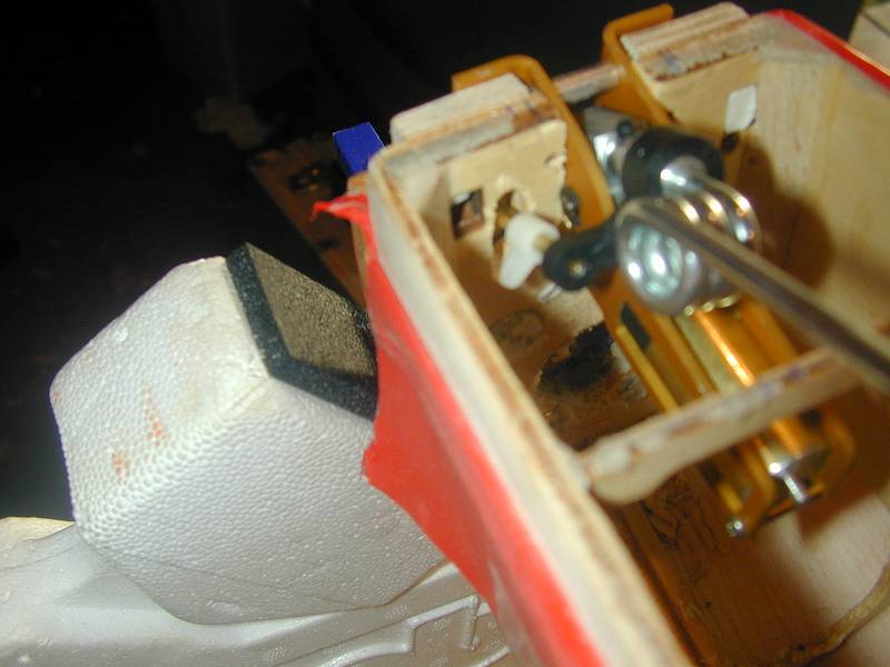

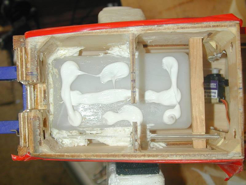

Hi all
Pics show the mods so far:
First pic shows the wheel in position using the oblong tank in place, other pics show original wheel strut above original stearing gear, and one with it laid in place, room enough, other pic shows original tank supplied with the PC9 and not used, the Graupner tank used with the standard fixed gear, and the oblong tank (330cc) which gives room for the retracts, will post more pics when I install the retract, it looks as if I will have to cut the firewall and install the retract on the engine side of the engine former possibly with a packing to get sufficient room for a proper length of leg.
Mike

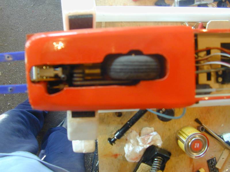

Hi all

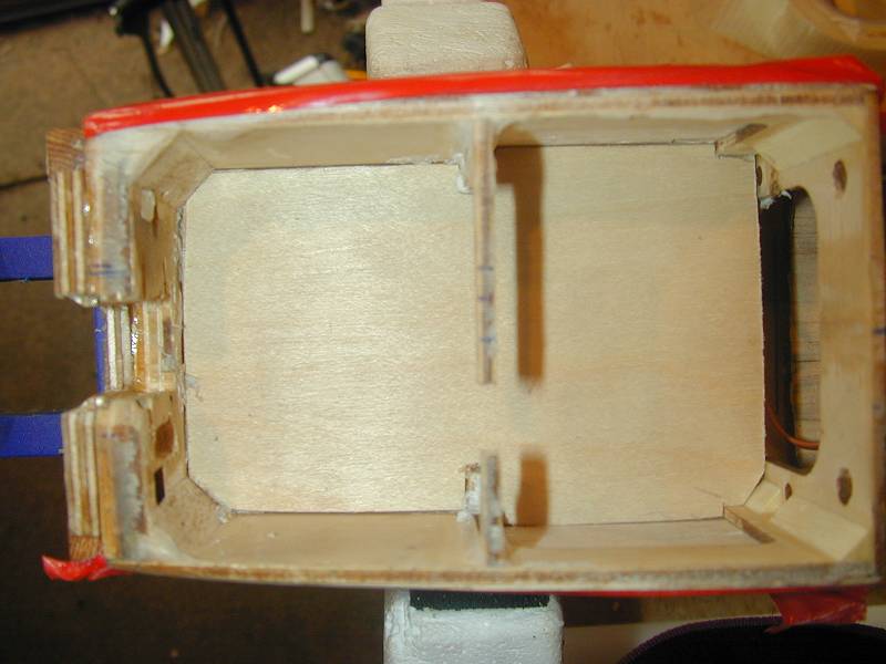

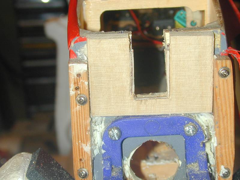

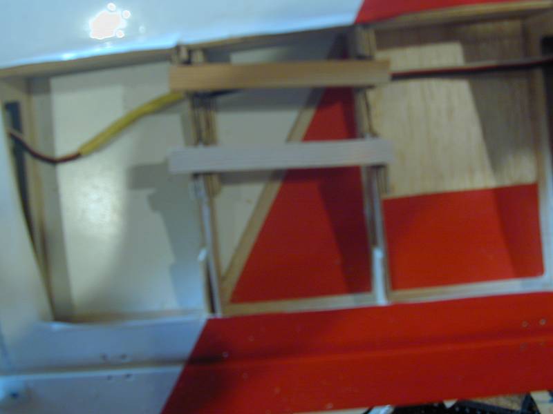

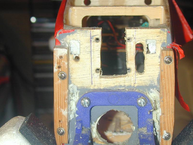

Looking at the pics from right too left:
Pic one shows the mods to the original firewall to accomadate the retract unit (Sping Air) note steering slot recess.
Pic two shows the secondary bulkhead used to get the retract as far forward as poss to allow sufficient leg length.
Pic three shows the retract in place
Pic four shows the steering arm in its recess on the original firewall, neccessary on retraction.
I'm just epoxying the firewall and secondary bulkhead together once done will progress with build.

More progress
Pic shows false floor over tank, due to the restricted space for the nose leg will have to go to a 3 or 4 blade prop to give sufficient ground clearance, should not be a problem with a 70 4s that I am using sorcing the spinner may be a differant matter though.

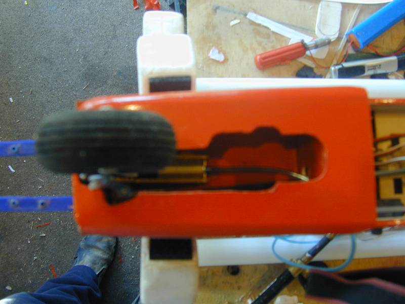

Hi to all and a mery christmas and a happy new year to all who read this.
Pics show final installation of the nose wheel retract, am sourcing a 10 x 7, 4 blade prop to use this gives me an 1" further ground clearance for the prop, will start the wings next, some feed back from anyone would be nice.
Mike

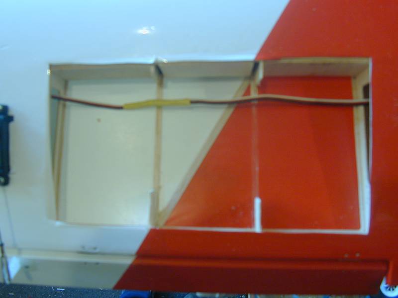

For all you guys with a Seagull PC9, don't worry about your wing mounted undercarridge it was a swine to get out in the end I cut out the ribs and will have to make new see before and after pics below.
Mike

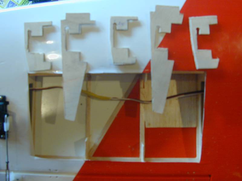

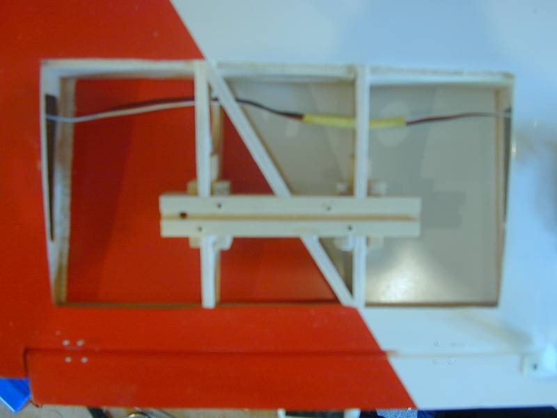

Some progress, slowed by stuffing my Arrow Tiger at the week end, finger trouble too slow and too low, minimal time to repair, intermediate bulkhead and tank floor only.
Pics show ribs cut out with doublers and treberlers? prior to installation.
Second pic shows them in place but not glued prior to final shaping, so don't be too critical, note slot for aileron lead and floor installed for wheel whell, more pics soon.

More progress, ready to re-cover one side, will start on the other side asap, don't think I will post anything on the other side as it will be mostly the same, have a few problems to solve as too angle of attack of the wing when on its wheels, prop clearance, round out of aircraft at take off i.e. if the wheel legs become too short there will not be enough clearance for the tail to rotate, if the wheels are too long the angle of attack will be shuch that a high speed would be neccesary to enable rotation, all of this is dictated by the nose leg, which is a fixed criterier due to the length possible which is dictated by the space between the firewall and wing, speed would not be to much of a problem on pave, but I fly off a small mown grass patch, this continues to be an interesting exersise.
Mike
