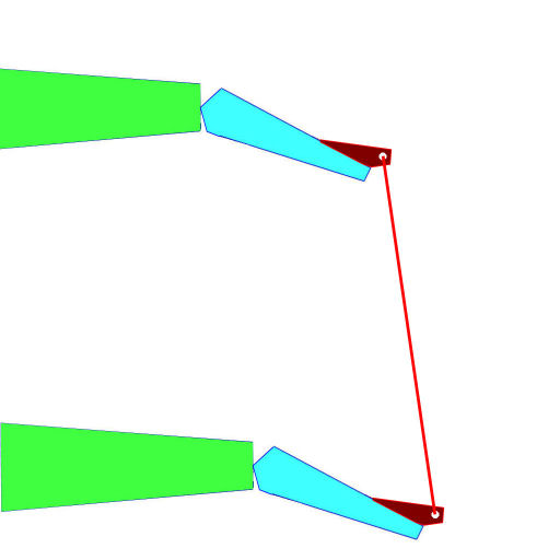

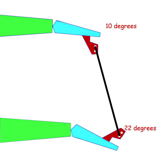

I've recently finished assembly of a Skybolt ARF. It also has the lower ailerons driven by servo with the upper ones attached to the lower. Before cutting up the provided hardware for those connections (to use to make my more accurate rigging) I measured the whole deal and mapped it out on paper so it'd be easier to measure the "differing differential" movements.
I actually made full size cutouts that could be hinged and connected to work exactly like the ARF would work with the provided hardware. And took some pictures of the setup. I'm attaching one picture that shows the Skybolt ARF's "problem".
I'm also including a couple of "drawings" I made of the Ultimate situations. One is the stock arrangement. The other is the design of my rigging setup. I'm attaching two of the drawings that show the Ultimate "problem". The drawings were not as accurately done as the cutouts.
Since both airplanes obviously fly good with their stock rigging, it isn't exactly a big deal. But if you'd like for your Skybolt or 40s Ultimate to have ailerons that work like the larger biplanes (that use a servo for each aileron), then the pictures will show why they don't and how to rig them so they will.

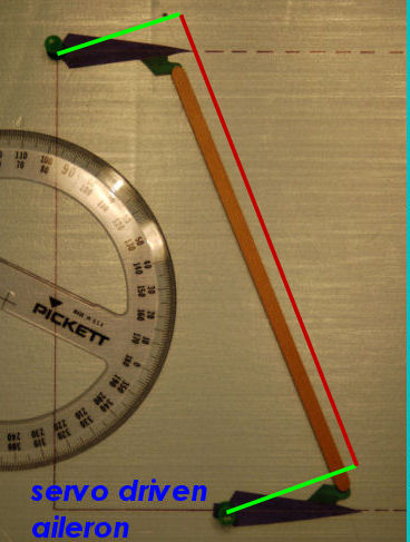

You betcha.
The idea is to place the horns so that whatever hole you choose for the connecting rod in that horn, a line drawn from the hinge line to it would then have to turn exactly 90degrees to follow the connecting rod.
The green lines on the picture represent those imaginary lines from the hinge line to the connect points. The red line would be the connecting rod. The idea is obviously to have the red lines make a right angle with the green line.
The picture below is actually a very good representation of how I have rigged my Skybolt. Since the Skybolt will put an appreciable force on the ailerons, I chose to move the horns inboard to gain support from and purchase on the aileron in a thick area of the aileron. So I wound up cutting a small slot out of the upper aileron to give clearance to the connecting rod.

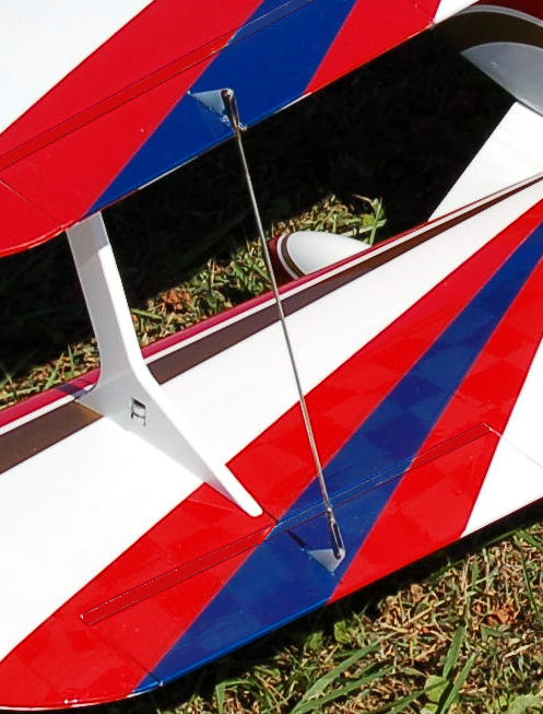

OK, here's a picture of the Skybolt. Reason I went ahead and posted it was it shows the way I use the horns that're supplied in the ARF's hardware. Reason I wanted to show that was it is a way to actually lighten the overall installation.
I cut off the bottom of the horns and simply slot the aileron itself. Epoxy the horn into the slot and you've got a very strong installation. Since you're not using but half the horn itself, that saves weight, but that's not the big savings. Not using the "other part" of the horn and not using the screws saves the most weight.
On your little airplane, you'd be getting rid of a ton of weight.

With the smaller airplanes, we used to avoid using manufactured horns in the first place. They are just too heavy for the application.
We'd simply use some thin plywood. Use it like I've used the plastic horn remnant shown in the Skybolt photo. It's plenty strong enough and we'd strengthen the hole with epoxy, and it'd last forever too. And it cost nothing.
Cost almost nothing.
Weighs even less.
Easier to do.
Good modelers can make or fix anything.
