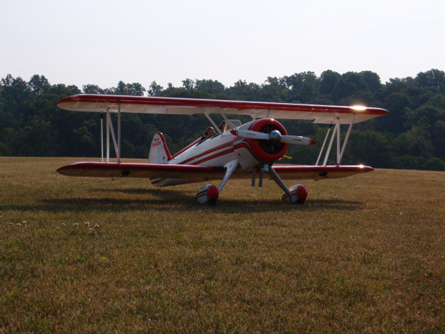

It definitely can take some serious aerobatics. Nothing 3D though. I use RCIgnitions G26 on a Belia prop with smoke. This plane screams smoke
Here it is.
