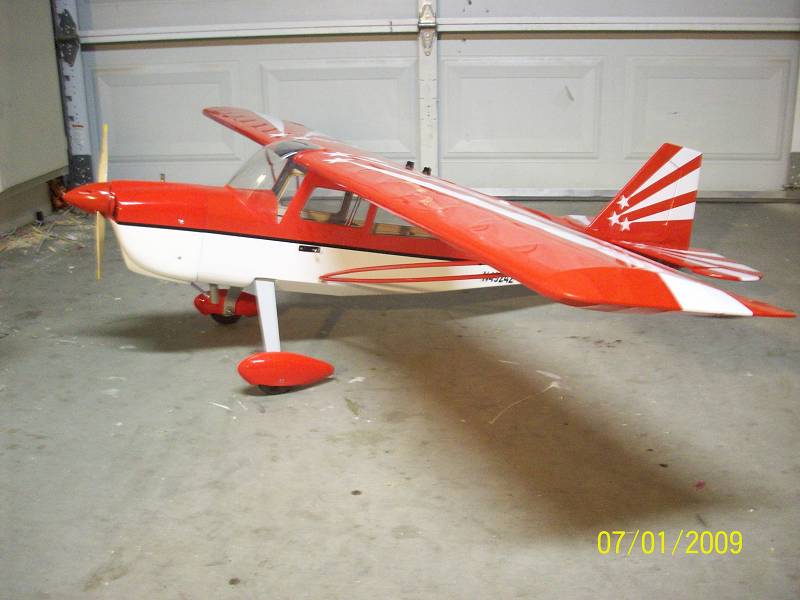

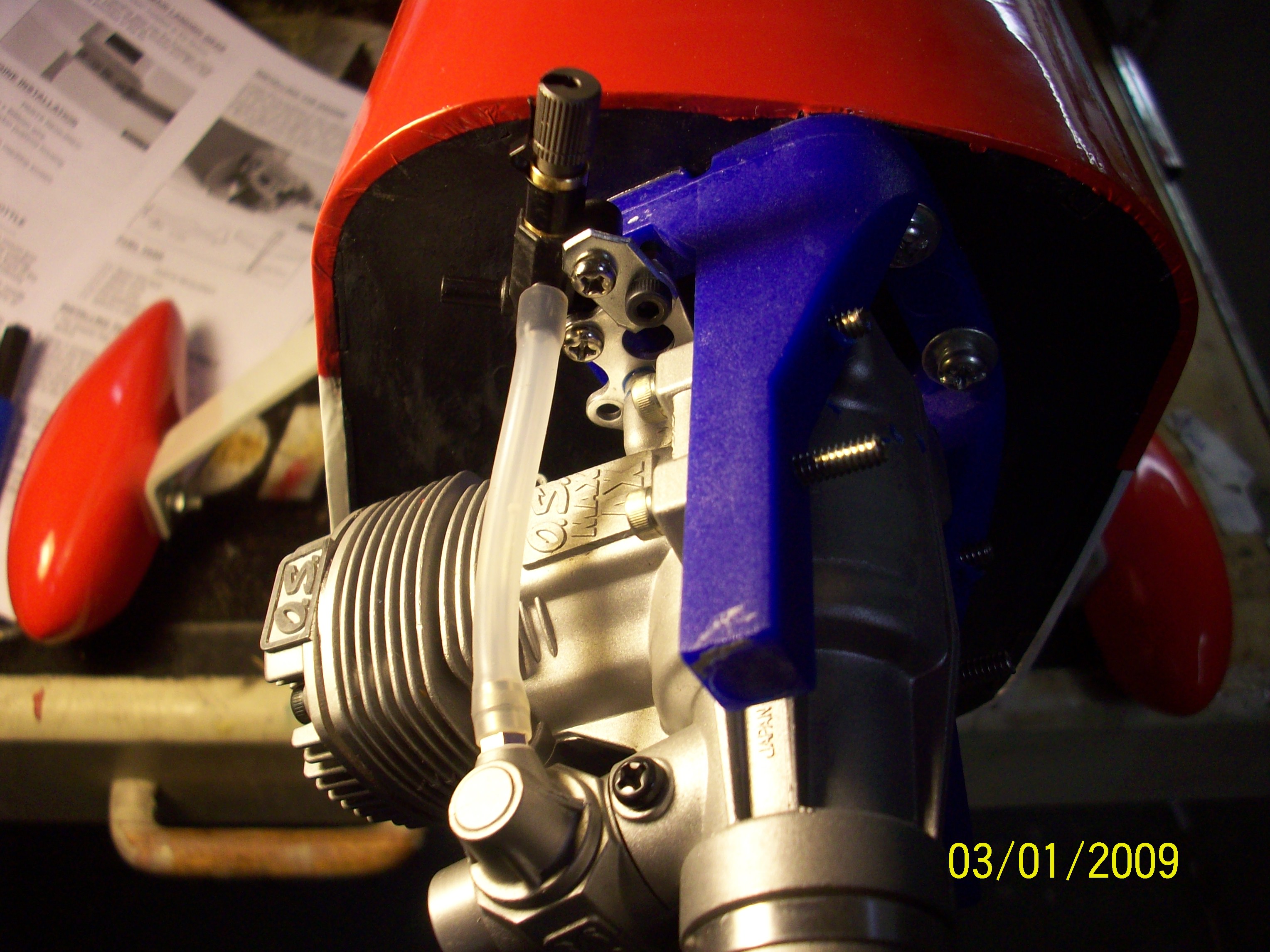

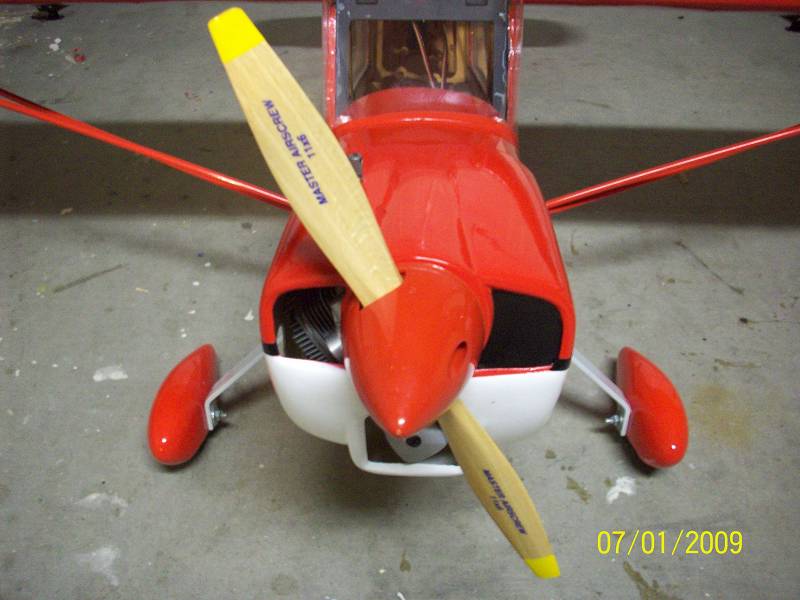

Hello Decathlon flyers. Got mine this holiday and what a plane it is. I ended up mounting a 1500mah nicad to the back of the fuse. I added a plywood plate and velcro straps for easy removal of the battery. Engine choice is the O.S. 46 and 11 x 6 wood prop. Added a charge and on/off switch to the side. First flight was crazy. take offs were heavy on wanting to guide left. Allot of right rudder to keep it straight. Not right! I looked at the right thrust and mine was all washed out due to the motor mount bad install. I actually had a little left thrust!. After fixing that problem the Decathlon tracked very nicely down the runway and good take off with no issues. Flew about a half a tank and the engine was dying out. Made a dead stick landing on the first new flight. Plane had a nice glide and brought her home back to the runway with no issues. I ended up covering the right cowl port to increase the air flow instead of having an air dam with all the holes exposed. O.S. I read to have at least a 2:1 or even 3:1 air flow from the front to the exit of the cowl. I also enlarged the hole for the glow starter. Plane flew great on the next flight. Very easy in the air. I set the CG with the battery position at 90mm from the leading edge. No extra weight has been added. Plane is about 6.5lbs without fuel. I also used the foam supplied with the kit to wrap around the tank. I upped the tank size from the kit 8oz to 10oz without issues. I only should have gave a little more room for the throttle wire as its to close to the tank like I would like to have.

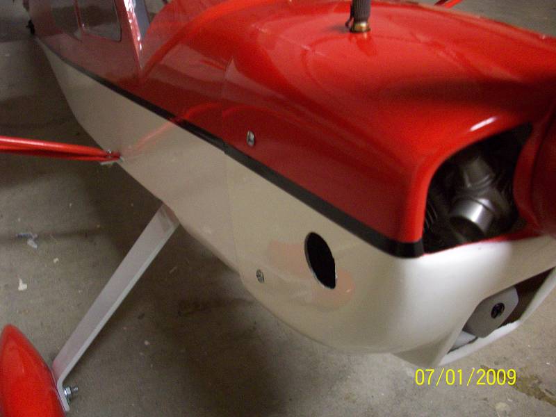

Looks nice! Your cowl is cut exactly like mine. My battery is mounted just like yours too. I have a .45 evolution with a 11x7 prop. I maidened mine about a week ago and all went pretty well. It performs good especially for the money it cost. I have only one flight on her because the weather turned bad. The only thing I have to work on is getting it to land right. When it touches down it wants to hop back up. I think we had four or five good landings (hop ups) in one attempt. The touchdowns were not harsh so I was surprised when it came back up. My friend suggested maybe moving a little weight forward and testing again. We will see. It will be two more weeks before I can make it to the field again to mess around with it.

Very good, I added the black stripe as i couldn't get the cowl to line up with the red and white lines. When they paint the cowl they dont allow for the offset of the cowl mounting. If the cowl is lined up at the end of the firewall the paint lines match up. Small thing. I noticed the plane next to your Super D looked like a good flier. I see Sullivan sells lite tires that claim to have a lower bounce rate that may help the landings. I did notice on mine at full throttle it did have a tendance to want to climb up. Mid to low throttle is easy level flying. The glide slope without the engine was easy.

My cowl paint job didn't match up. What I did was get some Great Planes striping trim - I think I got 1/4" red and 1/8" white. You can extend or 'move' the lines wherever you need to, and it came out looking AWESOME. Sold the plane, so sorry I don't have any pics.
Ok, now I remember. I added some pin striping, so that's why I had the white trim tape. For the stock scheme, you just need 1/4" red trim tape. Wrap it so it's even with the red covering at the fuse and around the front of the cowl, either ending at the breather holes or wrap it just under and go all the way around.
I chose to do a 1/8" white stripe evenly spaced above the existing color line. I searched for pics of full scale planes on Google Images and modeled one exactly. Really came out spectacular, and only took a half hour and five bucks.
Edit: What I did was put a 1/4" red stripe 1/4" below the line where the red meets the white, and a 1/8" white stripe 1/8" above that line, so I had a few nicely spaced trim lines.

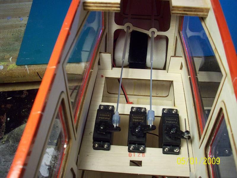

Well I exchanged my 1500mah battery for the standard 600mah battery from futaba in the same fuse position. That changed my CG from 90 to 80. Thats 20 off from the orginal booklet setting of 100mm. However, at 90mm CG on a straight pass at 3/4 to full throttle this plane just wants to climb up. I've been using down elevator to keep it more level flight. The two batteries are about 1.3oz in weight difference. Will see what happens on the next flight. The bigger battery will keep it also at 80mm CG if i move it forward on the fuse and just behind the servos.

Thats for sure on the CG postion. Even the manual says to balance this plane upside down. How do you balance a high wing plane upside down on the balance stand? I've got many flights on it now and its stable as can be.
