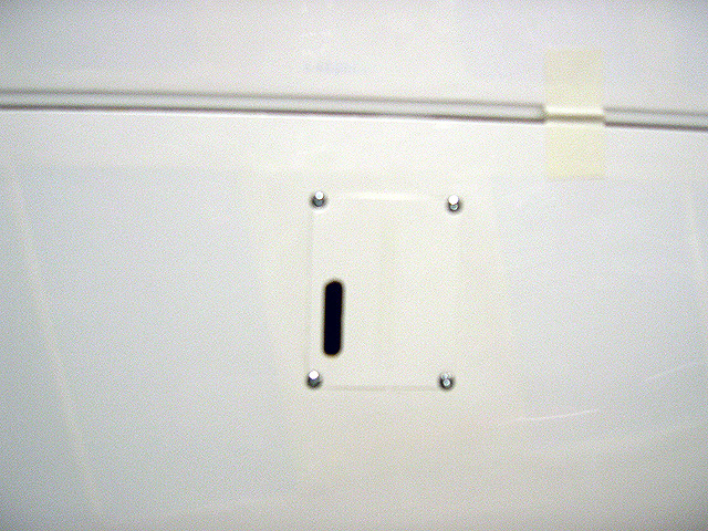

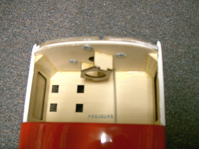

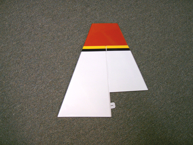

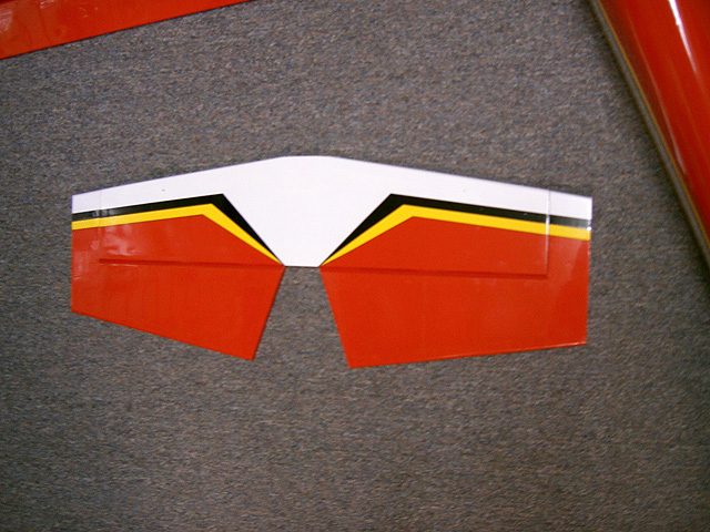

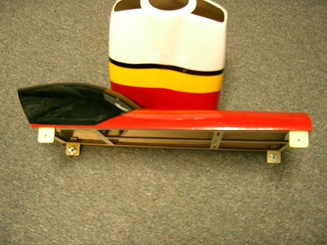

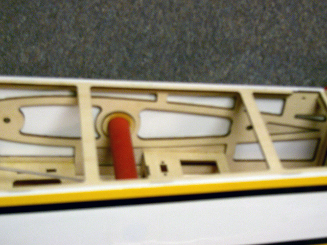

Ok lets try that again...

Very lovely. Thanks for sharing the pics. You ARE flying it this weekend, right?

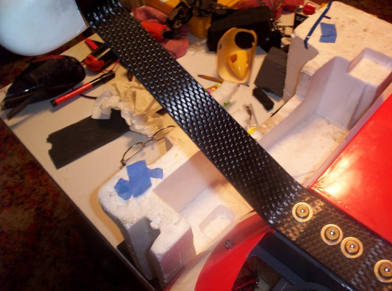

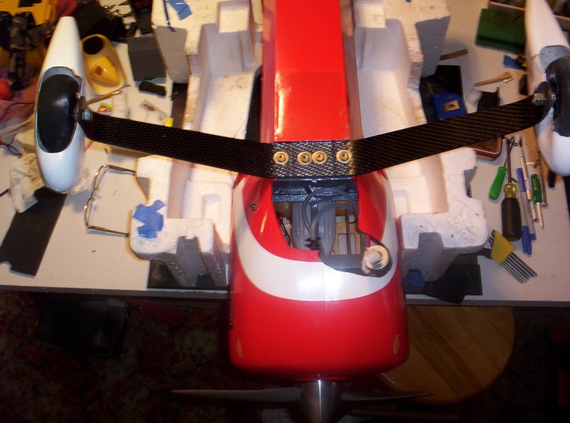

Well,,, the quality is getting better for sure. Way to go Seagull !! Don't worry,,,, it'll build light . (Glass the firewall and the gear block.)
The new Superstar has the same hardware and tank. The pre-built tank mount really works well. I was concerned with tank size too until I made my first flight. (Saito-150 ~ 16x8 APC) I set my timer for 10 minutes but found I had more like 12 or 13 minutes of flight at high throttle settings. I also worried about the hard mount fuel tank configuration foaming in flight and making lean runs. Not a worry. Observed the tank on tail stand with the wings off and didn't see any more foaming than when I've built them using 3"inch thick foam tank mounts.
I've been very happy with my Superstar so far. The 150 flys it very well and the whole thing weighs far less than my other 120 sized planes. From your pics I can see the new Edge-540 is built up in the same manner.
The only real problem I've got with Seagull/Phoenix/Black Horse models is the two piece, alum alloy ,molded landing gear.
They don't give on landings and they come loose alot. (Even with lock-tight). The only thing I ever liked about them is when they do break loose on a hard landing they swing back seperately away from the plane keeping the wheel pants from flipping up and poking holes in the wing.
Save some extra weight and go with carbon fiber landing gear. Graph Tech makes a gear that will bolt right on your new bird.
My new gear came yesterday. "Pics below." As you can see,,, my wheel pants have already taken a beating using the old alum gear.
Hurry and post your flight reviews !!!!

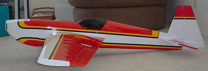

Here are some pics of it initially put together
