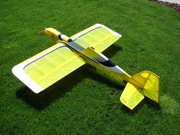

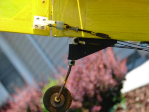

I just Finished my 3Demon. OS 32 with moose can pipe, 720 4 cell NIMH, 2 HS81MG in the wing, 2 HS80's on elevators, HS225 on rudder, and HS81 on throttle, JR610 Rx. I didn't use their linkage, mounted the engine at 90 deg for better placement of my pipe, added a tail wheel, I used pinned hinges in place of the CA hinges, the rest is stock. AUW no fuel is 3lbs 11oz.
I haven't flown it yet, but I will ASAP..

What a nice setup Mark! Is your header full length? (Mac's header?) Have you tried cutting any off?

Hi Ernie, thanks for the kind words. Yes it is a Mac's, long offset. I cut enough off to go in the front of my moose can, moose can exit pipe I did not really tune the length, just winged it, when Ibuilt a second one I made it just like the first. It works good enough for me!

That single "strand" of music wire landing gear looks weak. Will it hold up during a normal landing without compressing and getting the prop into the ground? Sits pretty with the .32 and pipe otherwise? Just wondering.

I had similar gear on a Modeltech magic and it was pretty weak, a hoop added (copper wire and solder) between the legs stiffened it up alot, but not too much. Just looking at it, I can tell this one is going to need a hoop too. The grass fields I fly from are pretty rough on smaller planes, long grass and some bumps.

The single strand wire is like 5/32" wire, its very stiff. Infact I broke out the mounting blocks on the softest of cross wind landings. I ended up laying some fiberglass clothe to strenghen up the blocks. I'm affraid my 3Deamon was very short lived, it had an unscheduled meeting with one the many lamppost scattered about our flying field. This occured on the second tank of fuel.

Sorry to hear about that Mark, you just barely knew her. At least it's not too expensive and it's an easy build. I stand corrected on the gear, It is 5mm aluminum? rod, pretty stiff stuff and really light too! I'm going to fly it as is.

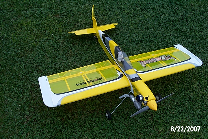

Got a 3Demon myself. Had a Magnum .52 in it and it flew great, 3D's, unlimited vertical, etc. The rear bearing went out, blowing the crankshaft surface for the connecting rod (clunks when it turns). Will repair later. Needed a replacement in a pinch, so went with a Saito .62 4-stroke (always wanted a 4-stroke). Some may say it may be overpowered, but based on my flying experience with the .52, I don't think so. It weighs the same or less than the .52 and seems to give the same static pull. It has that wonderful 4-stroke sound and unbelievable transition speed from idle to full bore. Had to pitch the cowling for now since it was hogged out for the .52 so it's not as pretty an airplane.
Just broke in the engine, going through about 4 tanks of gas to do so (I'm very careful and followed the manual to the T ). Need to rebalance the plane with the new engine, but based on the power delivered by this new engine, I think I'm going to love it. Been too windy to fly but am hoping for tomorrow. I'll keep you all posted on how it turns out- maybe some cool pictures too. I attached one picture here when I had the Magnum in it. It is a good looking plane and my bear loves to fly it.
