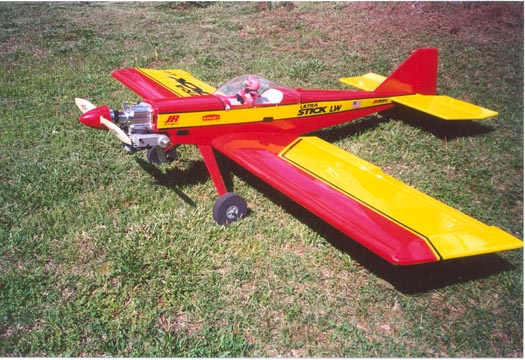

Heres my Ultarstick LW

Doug is that US-LW a conversion job, or did they sell it at one time?

Hey Steve
The plane started out as the stock 120 high wing stick. From Jim Feldmann plans #1307(RCM) I flipped the fuse up side down with a few other mods. The cowl, conopy, and wheel pants can be had from Stan's Fiber Tech. I'm us a Fox 2.4 w/ Slimline pitts muffler and Mejzlik 20x9 prop, pull-pull servo for rudder is mounted on bottom rear of the fuse. the elevator servo is also mounted in the rear. The plane flys great and the crow is a blast!!
