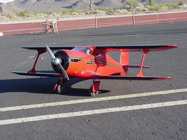

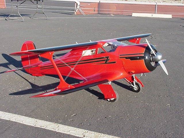

O.K. gang Finally got the test flight in this morning (Monday) perfect weather, wind calm about 78 deg.
Here's the specs = Plane out to be 20 lbs, had to put 1 lb of weight just above the engine
using the O.S. 160 twin 4 stroke with a APC 17X8 prop, which gave me 8000 rpm
take off was o.k. tracked well (i have a little toe in) still need to work the rudder wouldn't stay straight bu its self
lift off was ahhh welll interesting I guess is the word. I always test with duel rates on, as I want to have too much and not too little
well the elevator was waaayyy to touchy as well as several deg of "down" trim was needed so you can imagine , it looked like a "porpise" up down up down !!!!!! also needed several clicks of "right" aileron. So it was up down left up down left (you get the picture)
Power was good "certainly not great, but at this point I'm comfortable with it. Makes scale flight speeds easy. Just have to be carefull NOT to get in any situtations where excess power is needed. I did not retract the gear, I usually dont for a first flight, but was pleanty busy for the first 3 or 4 minutes just to get it trimmed.
after trimmed flew very well, then!!!! (yeah here it comes) out of nowhere come a blast of hot air (no I'm not reffering to Wally) a 90 deg crosswind about 8 to 10 knots. Stuff like that happens here in the desert. So landing was awkward to say the least, no flaps, plenty "O" speed, used the whole runway, but successful non the less. Didn't get a second flight due to the wind. Future flights should be fine
Denis
