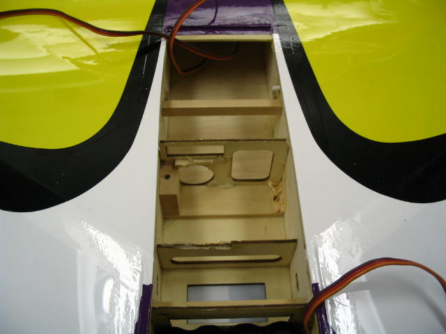

Although this is an ARF I just wanted to post the build to give the RC pilots that don't have this plane an idea of whats involved. Also to welcome any tips I may miss when putting together the plane.
Below are picks of the front and back of the plane with the ailerons already glued in place. I glued them in last night only to learn , one of the elevons move further up than the other. Also the same elevon that moves up further drops lower. I guess this is do to the beveled leading edge on the elevon not being the same.
I am hoping to have the madden flight Saturday. But how much I get done tomorrow night will decide the day. I normally build through the night when I get a new model but after a few beers , it's getting hard to do the all nighter thing.
My engine choice is a ST G51. The choice came about do to the fact I don't have a .51 engine and it's not much more power than a .46 . The wheels are definitely going to be installed , but the landing skid will be left off unless it can help with balancing.

more pics of the RACER being constructed. I epoxied the engine mount along with th fuel tank compartment to insure the glue the manufacturer used will not fail once the oil an fuel comes in contact with each section.
I got the landing gear installed. I had to drill out the wheels in order to have them spin freely.
The engine didn't fit perfectly so I sanded the bigger side of the engine mount to complete the mounting of the engine.

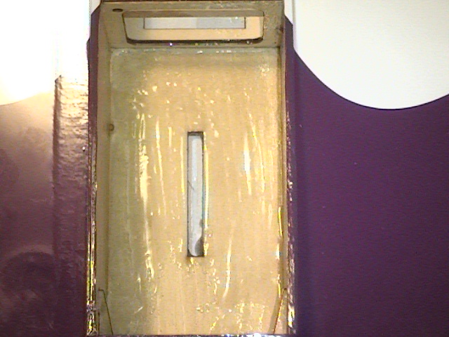

I'm getting mine together. I'm leaving off the landing gear. For a little weight savings, I popped out the hardwood gear blocks. I used the landing gear as a tool. They are really glued in well so no worry there. I removed the throttle servo plate too. I finished up with a Dremel. I'm going with a micro servo for throttle and a 4 channel Berg RX. I have the battery right behind the tank. This plane is on the tail heavy side as noted in another thread. I wanted to put a Webra .32... too light. Wound up with a MVVS .49 and had to mount it farther out on the mount than recommended. The cowl barely fit and I had to grind clearance for the carb at the front. There's about a 1/4" gap between the spinner and cowl. Balance is good with no added lead. I think a .61 would be good on one. I'll try to get an AUW and maybe a flight report when the weather gets nicer.
Fiend. Did you ever get the Mach Racer going full throttle? You had a comment comparing it to the shrike. Just wondering. later
