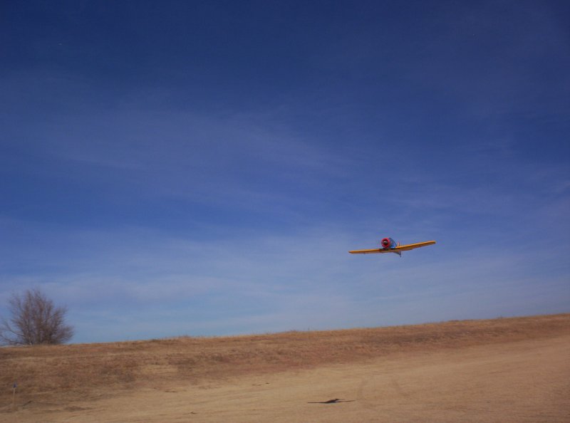

Did the maiden plus two more flights on my new AT-6 today and it flew awesome.I have a saito 100 in it and it pulls it around very nice.I had to adjust the low end and thats about it.I can't wait to take it out this weekend and really ring it out.

A buddy's AT-6 with Saito-100 and stock retracts. They will do better on paved runways.
