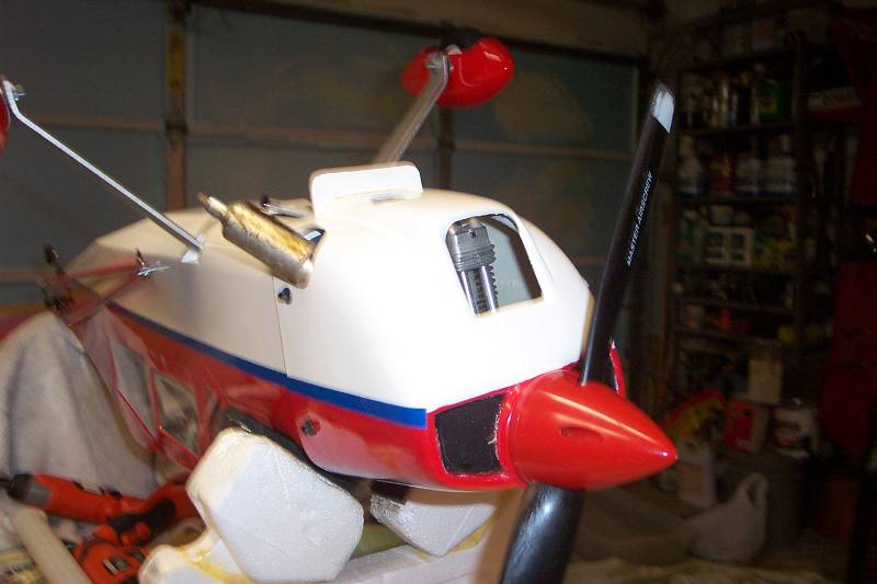

Just finished one of these with a .91 Magnum four stroke. Pictures of the modifications to help on your .70 four stroke installation.
1. Mounted elevator and rudder servos in the tail with the battery just forward of them.
2. Blocked off holes in cowl adjacent to the spinner, opened the lower hole and installed stall strip to enhance airflow over inverted engine head area.

thanks alot mike for the great info all most decide not to do it till now you got sny pics with the cowl off they would be so help full thanks bob
