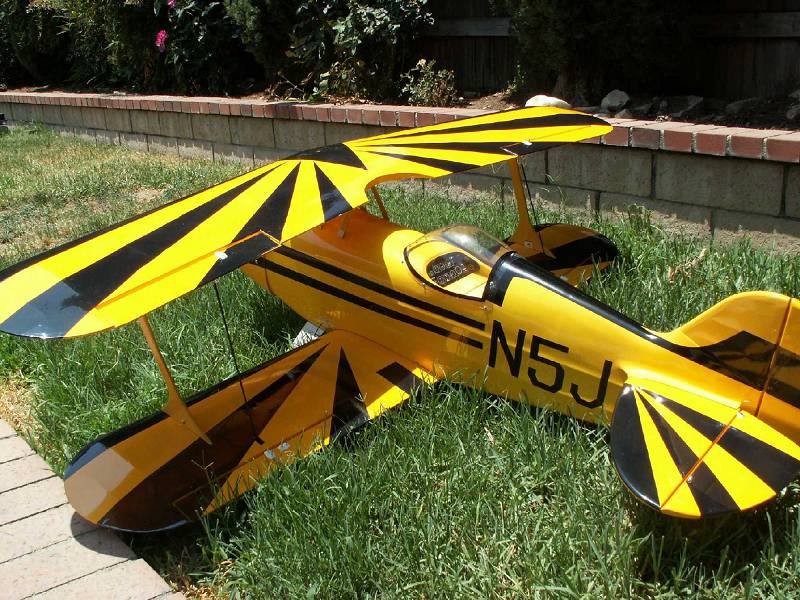

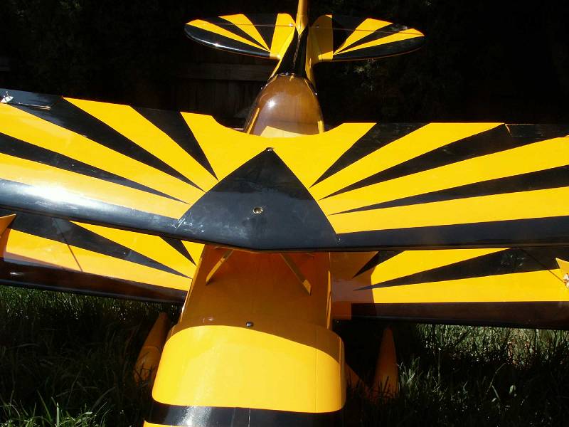

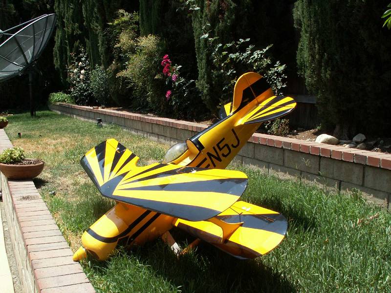

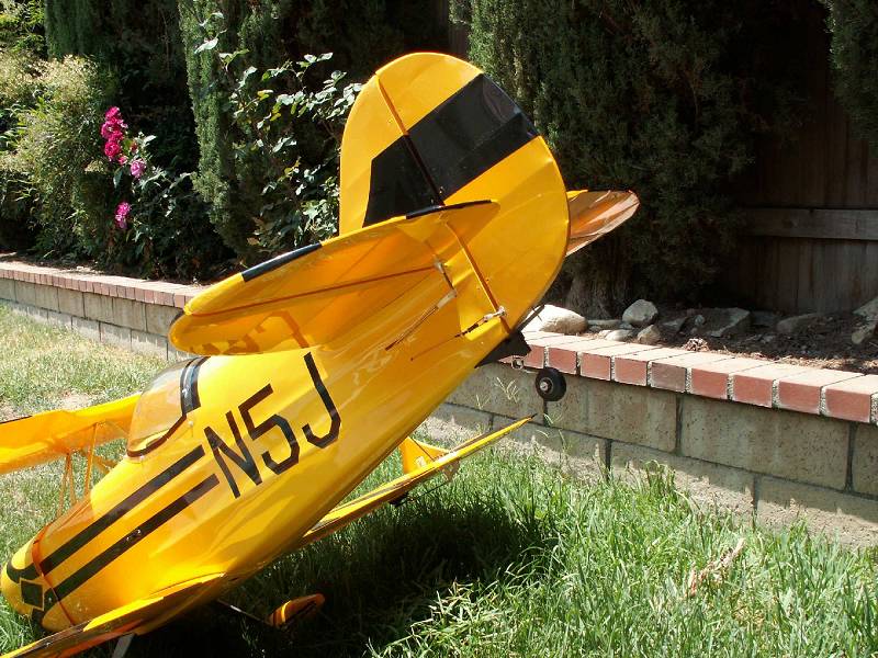

Great Plane, just finished:
[img][/img]
ID:	475954   Click image for larger version
ID:	475955   Click image for larger version

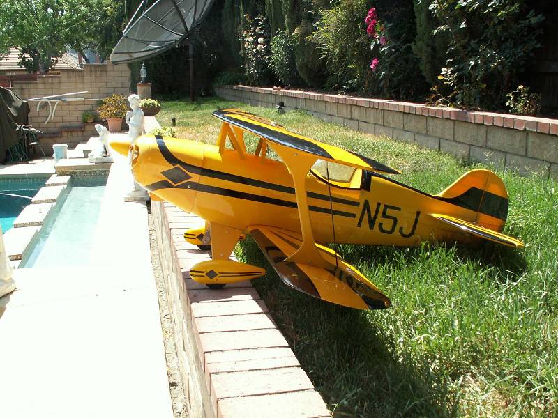

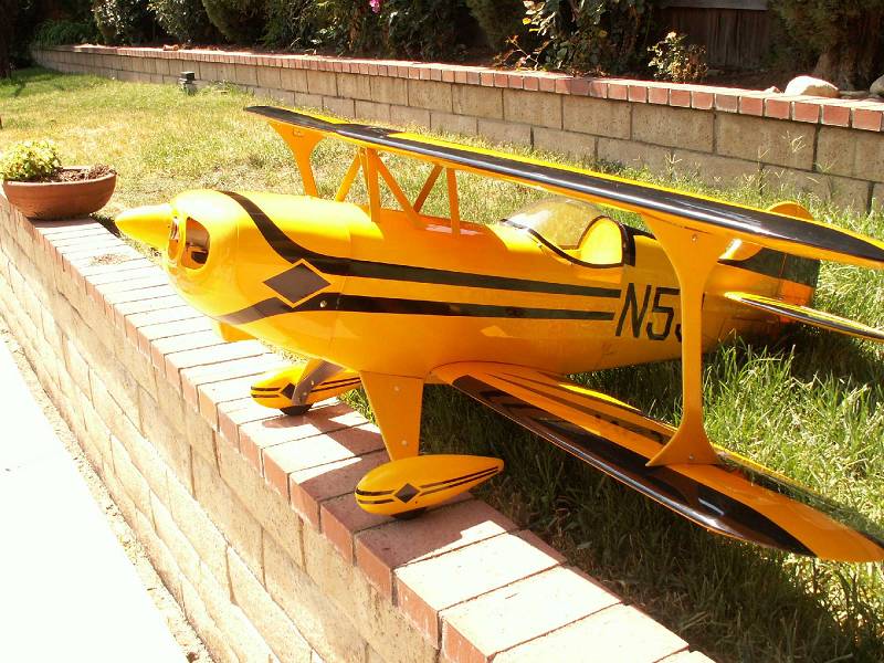

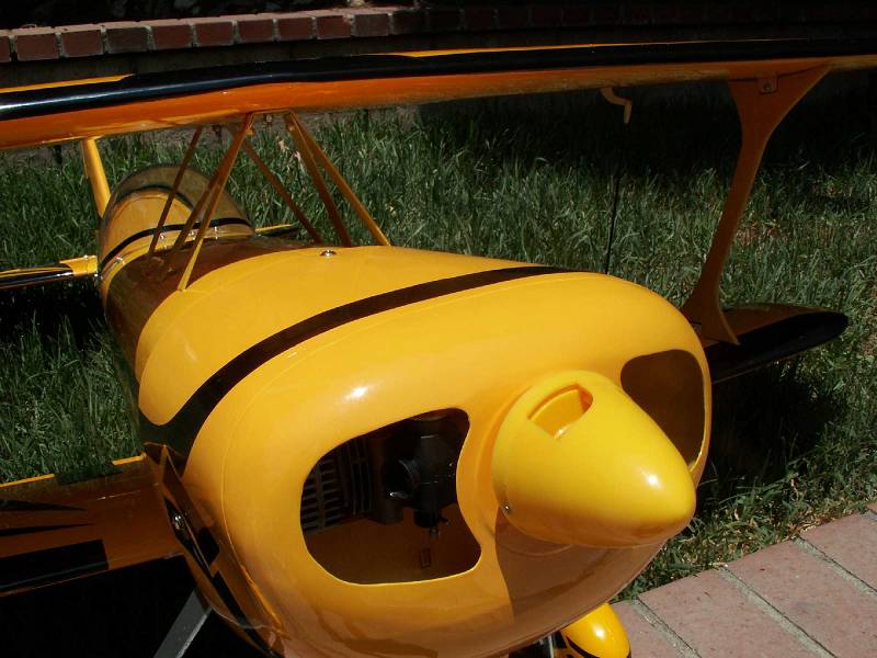

more pics:
[img][/img]
ID:	475961   Click image for larger version
ID:	475962   Click image for larger version

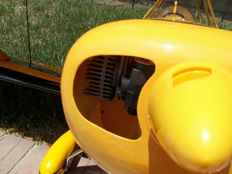

some mo:
[img][/img]
ID:	475964   Click image for larger version
ID:	475965   Click image for larger version

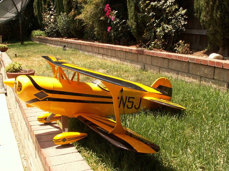

And:
[img][/img]
ID:	475967   Click image for larger version
ID:	475968   Click image for larger version
