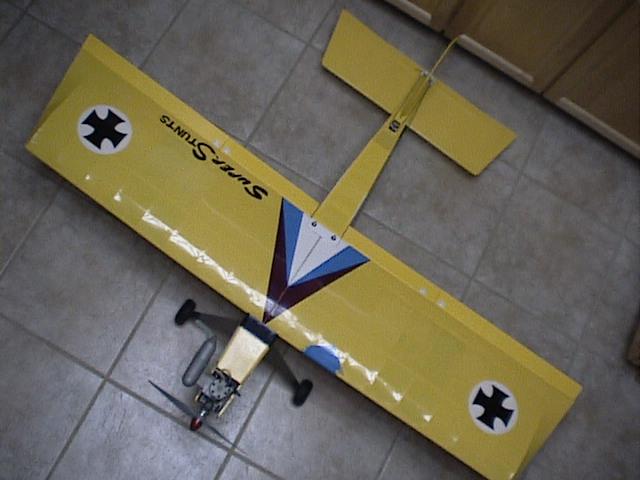

My Feedback: (23)
Posts: 3,227
From: Houston, TX
Here's my taildragger Super Stunt "75" with quad flaps.
This plane could easily handle more power. The H9 Ultra Stick is very similar in size and folks power it with engines like the Saito 100 wtih no problem.
My Feedback: (23)
Posts: 3,227
From: Houston, TX
Here's a close-up of the wing. Those are solid balsa 2" aileron/elevator stock, hand-picked at the LHS for lightweight and straightness. I kinda wish I had gone even wider than 2". The plane flies very well as is with more than adequate aileron authority right down to stall speed, but I'd bet 2-1/2" or even 3" would make for a wild ride.
