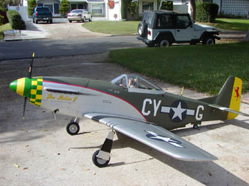

Old 12-05-2002, 09:58 PM
deputydog
Join Date: Jan 2002
Location: poway, CA,
Posts: 1,297
Default painting arf's
Here's a pic of my latest project! I started with a World Models 80" P-51 and added a few items. The plane has been completely been repainted with Perfect Paint, Formula U and Pactra enamels.
