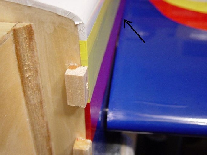

I'm held up building mine because of a bad wing. The left wing panel is badly warped. There is a 5mm gap between the wing and fuse when it is assembled. I have contacted Creek Hobbies about it, but haven't gotten a response yet. They will have to send me a new wing as the current one is not usable. Only about 5 inches of the root touches the fuse.

Sounds more like an uneven surface at the root. Also are you sure the wing tube is going all the way into the socket on the wing? Erick Royer mentioned something about a similar problem on his Staudacher review. You might want to contact him.
I believe this may be able to be fixed without a new wing. May need to sand the core straight at the root. Also the wing tube socket might have been bored at an angle. This might be a little more difficult to rectify and may require a new wing. You might try a phone call to Creek about your problem.

PilotFrog, The tube is going all the way into the wing. I did have to force it into the foam a little. If I lay a straight edge on the root, there is a 5mm gap at the leading edge and trailing edge. I don't think it can be sanded out, as that would eat through the root rib in the center where it is bowed. Besides isn't the purpose of an ARF to not have to build/sand/cover anything? I think the only way to fix this problem would be to sand the root flat + another 3/16" and add another root rib. that would require recovering the wing. To top it off I have not found any covering that is a perfect match anyway. Creek Hobbies need to send me a new wing.

I did not realize that the problem was that severe..... it definitely has a bow in the root plane. Yes, that much sanding would require replacement of the root rib and recovering at that section.
Creek might have to replace the whole plane as I don't know how they are on spare parts stock. This model is out of stock until after the first of the year so you may have a wait. Hope you are able to contact them after the weekend. Their lack of response has me worried too.

Here is a pic with the wing mounted. If you look where the arrow points, the wing is flush with the fuse there. It is gapped infront and behind that point.

mlevings, Just a little foam tape will take up that gap!

Well guys, I just got a call from David at Creek Hobbies. It is not what I wanted to hear. They would send me a new wing right out, but they are out of stock even on parts until sometime in February!! He is going to do some more checking and see if there are any other options. It's starting to look like I will have a $200 ARF 1-winged paperweight. Just my luck.
