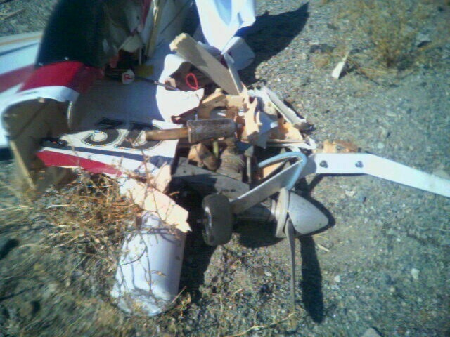

AHHHHHH, you guys and those little engines, BAH HUMBUGno such thing as overpowering a ucdwith a little extra work the best engine is the saito 100[X(]
the second best is the 82[8D] go with the 82 i would if i had an engine that small,or a ucd46, mines broke

The 82 on mine does make my heart flutter...... I'm affraid the 100 would make my nose hairs curl.....[X(] I mean, I look at that one picture that Gary's got. He had to sit down and have a cold one after a flight.....[:-]

i have the cold one before the flight, and sometimes two[X(]
go with the 82, there will be no issues with it drawing fuel or flooding, if tuned right[8D]
