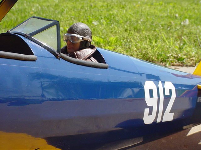

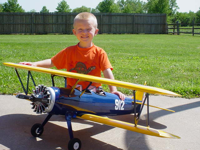

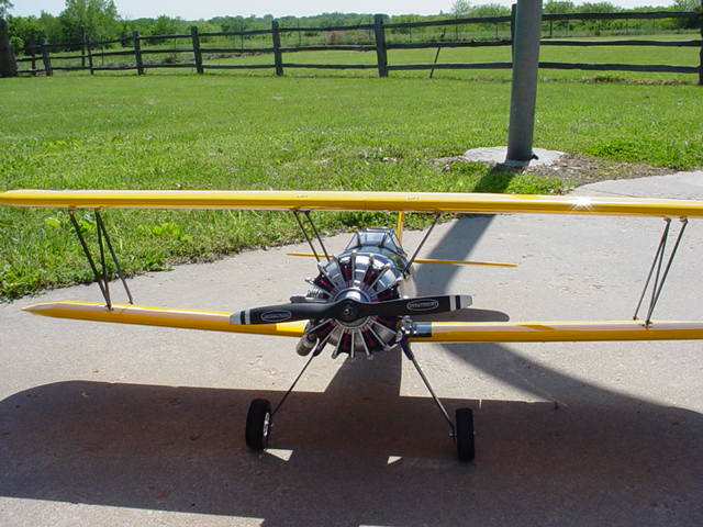

Here are some pics of mine, This is my favorite plane in my hangar!!! I would like to have another arf in the box just to set on the shelf in case something happens to this one.
A tip on the radial when you glue the two halves together, there isn't much space left to trim down with out trimming away part of the "radial" it's self. What I did to remedy that is sprayed expandable foam insulation up inside the hollow areas, then it expands and fills in all the "gaps". It also did wonders to help make the "dummy" radial a little more substantial. The best part is no extra weight. As for the rest, I used the supplied aluminum tubes and wires. It took longer to do it than the rest of the plane I think, but it looks good I think. If you want any other pis of the radial let me know and I can take a couple more close ups.

Jeff,
Thanks for the info.......Just a couple more questions........What pilot figure did you use and what engine? I've got a Saito 45S in the SS and it works quite well with a 13 X 4 APC turning 9000 RPM. That prop was recommended and I haven't tried anything else. For the PT-17, I've got to get a new engine, so any suggestions would be helpful.
Your crew chief looks mighty happy!
