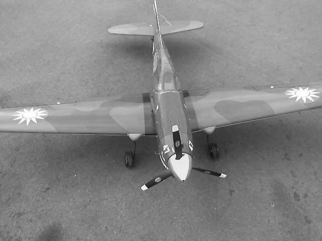

I have a H-9 P-40 powered by a OS91fs plenty of power for this plane if you float it in easy the retracts are good enough they are weak for sure,and my struts have bent a bit after a off runway landing but they are servicable removed and bent the strut back and it's fine.
as for a fairly cheap spinner this is what I found for 20$ http://www.racingdevil.com/product.php?category_id=105 they look pretty good for the price I had a parabolic(P-51)spinner and it looked off, check these out here's a pic of mine with the new spinner
