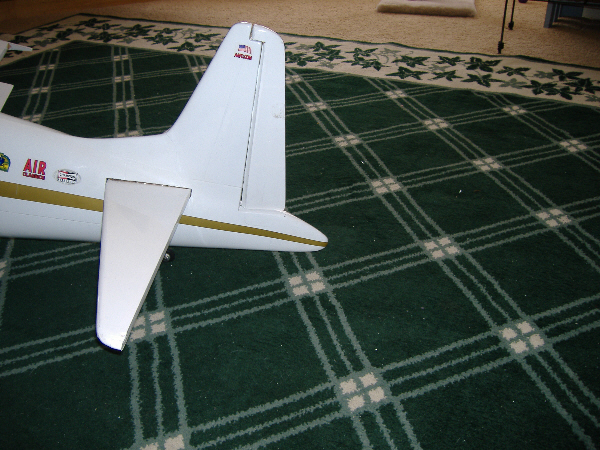

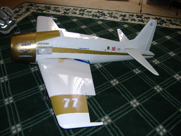

Old 03-26-2006 | 07:34 PM
p51mech38's Avatar
Joined: Jun 2005
Posts: 130
From: Lafayette, CA
Default RE: Dymond Bearcat
Here's mine almost finished!!!

Old 07-10-2006 | 08:12 PM
Tripower455's Avatar
Joined: Jan 2005
Posts: 529
From: Naples, FL
Rare Bear Mech, Looks awsome! Have you flown it with the RCV91CD yet? I have one of these and would like to use it in this plane. I am completely BARFing this one, as there are some things I don't like, mainly the horizontal stab and the purple-ish paint. The stab will be completely rebuilt from scratch. It will also get stripped, glassed and repainted (I am thinking target tow scheme).
