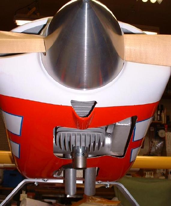

I had the same thing with the muffler, hitting the cowl. But I'm not too awful picky, as far as the cowl goes...I cut a large hole, that cleared the cylinder, and the "high point" of the muffler you talked about, and then all the way to the pipes. It made more sense to me, than cutting three holes, and it looks OK. Don't take this wrong, but I build to be functional, and fly, and I like them pretty, but I am not as concerned personally with what the cowl looks like underneath (within reason, of course!!!). I know Bob Pastorello's (see it here) looks a little nicer than mine, but I am happy with mine. Cowl goes off and on easy, and I don't have to worry about burning anything (been there, done that, have the ashes!!!). Mine gives good airflow, too, I feel, although haven't run it yet. Plus I like to see the engine!
Come on, sunshine and warm weather!!!!!!
My balance, with the ZDZ80, two Li-ion batteries up right behind the firewall, single receiver, Hitec 5736 pull-pull, is balancing right at the 1" in front of the front of the wing tube, just like everyone elses....
Here's a pic of my cowl...

The Bisson fits VERY well in the Giles cowl. I just had to make an additional opening for the front lower "corner" of the Bisson...but the entire balance of the muffler is inside completely, and the exhaust stubs stick out about an inch....Looks great!...

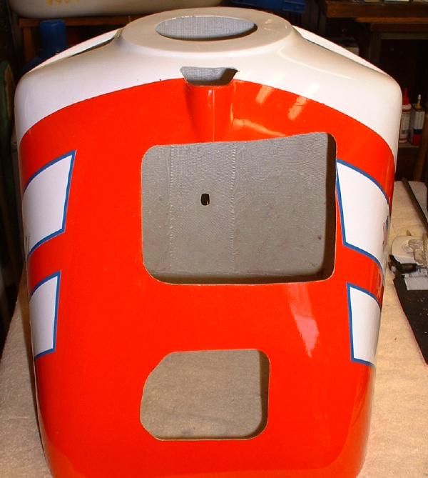

I only had the ZDZ-80 for a few test flights, and I thought I remembered that it fit entirely within the cowl. I went back and looked at some photos but there is nothing definitive.
I don't remember having to make a cut that large, but I have mounted and tested so many engines I get lost on what's what.
The 3w75 front carb with johnson wraparound muffler DOES fit with the muffler entirely enclosed, maybe that's what I was thinking about.

Perhaps I should clarify myself - the Bisson muffler indeed fits very well inside, with just a little clearance needed for the low point, as Bob and Tom (Hey, sounds like radio personalities!) pointed out. I had it cut very similar to Bob's at first, and looked great!
I will be using several engines on the Giles. One of the others is an A&M 4.2, with, I believe, a Sonic Pitts (don't quote me!), that hangs significantly lower, by my calculations - the larger hole allows for that, as well.
I'm not recommending my cutout, for the ZDZ80 with Bisson, just illustrating what I did. My cutout will just make it easier to change engines easily, without having to modify each time.
Ran into that with an Extra I bought used - by using a different engine, I found that the cutouts the previous owner had used, didn't work, and when I was done, looked a lot worse than had I done it like the Giles...

One other thing - if I knew it would ONLY ever have the ZDZ, I would probably try to heat up the cowl, and form it around where the Bisson is lower, sort of a cowl bubble. It's not very much, and could possibly be done. I have done so in the past, with great results. But then again, I would be tempted to make it a two piece cowl, as well, etc, etc., and probably extensively modify it, for a cannister, as Dick Hanson is doing.

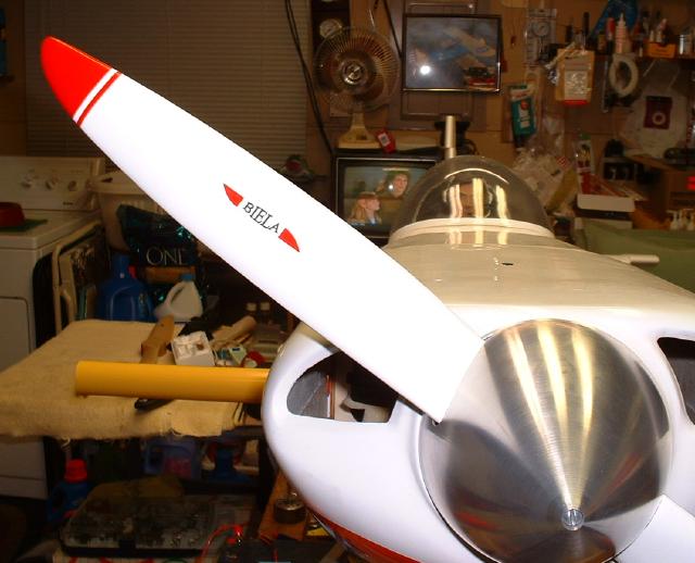

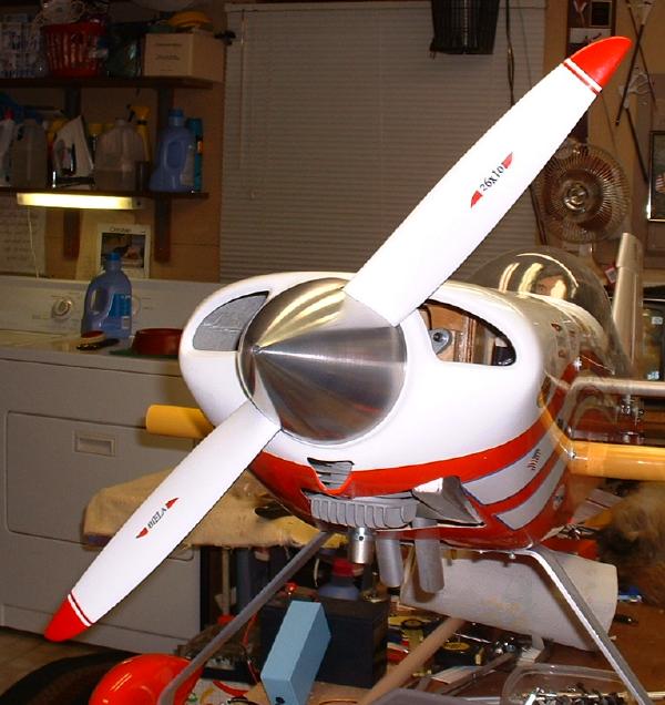

rctom - no Apology needed, for sure! I wish OTHER airplanes had cowls that fit as WELL as this one....
It's just SO close...if Bisson had used 1/4" narrower rectangular tube, that would have made it....oh, well.
Gotta tell ya, though, with a Biela on the front this baby is REALLY a looker...

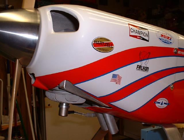

I use a heat gun. You need to heat the fiberglass until it becomes pliable, testing often. You also have to have a very good idea of exactly where you want it to go to. When it's reasonably pliable, bend to form. Here's an example of a pretty radical bend I did on the Mizar - it's towards the bottom of the page, with before and after shots:
Mizar cowl
As you can see, it didn't even ruin the paint, as it seems most paints under heat, seem to "flow" with the bend. Once it cools, it will retain the shape you made it. You can ease the pain, by wearing leather gloves. Depending on the time and care taken, you can make it very smooth....and thinner fiberglass takes to the technique easier/better than thick.
I don't remember ever reading about anyone doing it - I had to do some bubbles on a cowl once, and tried it. I have done it probably 4 or 5 times now, with excellent results.
DISCLAIMER!! I would try it first with a piece you have cut out of the cowl, to make sure it will work for you - I don't want to be responsible for someone ruining a cowl. BUT, that being said, I have never had any problem with doing it.
I even made a pine mold once, both female and male, for pushrod bubbles, heated the fiberglass, held the male underneath, and the female above, pressed together, and it came out "store bought"...much better than trying to glue on the bubbles that came with the kit.
If I can find the cutouts from the Giles, I will experiment, but they may be long-gone...

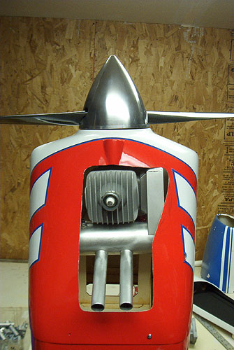

Hey rcav8or and aerobob,
Thanks for the info on the muffler situation, looks like you guys had to cut out as much as I did.
Hey Tom,
I bought the ZDZ/muffler from you with the plane and I got a SuperSonic, no big deal cause it doesn't appear that the Bisson clears the inside of the cowl on the lower left corner either.
Hey Tom,
