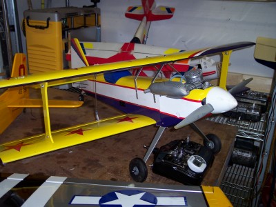

I've been able to increase the throws to just shy of 3/4"... however to do so I had to shave away a little material around the wing mount bolt hole. Just enough to let the lever rods move a bit more.
I also used a longer servo arm than what is normally used with the mini servos.
I then set the aileron servos to 130% travel.
This makes the plane VERY responsive when it is travelling at a good speed, on rolls. SNAPS are almost invisible....
Check out the WM plane video for the glow version and you'll see how fast the plane is on snap rolls... It's FAAAST.
I usually fly it at low rates (60% of this for the ailerons) and flip to full rates when doing things like fast snaps, etc.
You don't want to usually fly at the higher aileron rate, as if you have this on (and high rates on the tail) during takeoff you may stall the plane.
I did this one day, pulled back too fast and early with high rates on, and had enough height by then to recover... it does fly slow enough... but high rates on the ailerons and elevator are not a good idea at takeoff.
For your LOW rates be within the recommended HIGH rates, if you are an experienced flyer.
Otherwise if you are anywhere close to the recommended you'll be fine...
1/4" sounds about right, but use the radio to dial in just a little more.
Make sure that the plane tracks straight before you fly. Test it several times.
It will yaw left on you during run up, and roll left on you when the wheels come off the tarmac.
The left roll is fairly docile, the left yaw can throw you into a ground loop if you are not ready for it.
As far as the C.G.
I originally set it to spec, but have since upgraded the wheels making it a bit heavier in the nose.
I've had no problems though I'll bet the C.G. is now well forward of what is recommended.
I'm hoping the Ultralites will bring the C.G. back to spec.
If I recall I have an 1800mAh battery pack sitting under where I put in a pilot... or off to the side (I have several of these now, so that is why I'm a bit vague...)... I crashed one...
The last one I put together has the T.H. .46 engine mounted inverted with the STOCK(!) muffler hanging off the left side of the plane. I'm eventually going to replicate this on my "backup" Ultimate 40S, same engine, but this time using a Macs tuned pipe.
Did you replace the stock wheels?
I have 2 3/4" rubber wheels on mine now so it handles grass with aplomb. I am about to switch over to 3" Ultra-lite threaded wheels instead though, as the rubber wheels add quite a bit of weight.
Before landing take it high and get very comfortable with it's stall speed.
If you are using an 11x6 prop it will be a very fast plane so you must get used to where the actual stall point occurs. It will be far slower than you expect if you are flying around at normal speeds... however this plane will tip stall when it gets too slow, so always come in under some 10-18% power, and cut throttle just over the runway threshold, then let it float down.
You'll love it with a properly tuned .46.

opjose, Well I got to maiden my Ultimate yesterday, Thurs. I met up with a good friend of mine that is also my instructor. He took it off first and was very surprised at how docile it was. I ended up putting my 40 la on it with a 10x6 prop. I will use this engine till I get used to flying it. Then after refueling I got to fly,with buddy box even though I am trusted, I wanted the extra security just incase. wow it flew just great. It was a little slow on the rolls and of course verticals were hendered by under power BUT it was a great time none the less!!!! It turned out that I wanted to keep refueling and flying over and over. But due to tx battery I had to give it up after 6 flights. What a shame...lol.
Now for the interesting part. I have now added longer servo arm on the ailerons and taped the joint between them and the wing. I have also added end point on the Tx but am still only at 3/8" movement. Since you have gotten 3/4" you must have some seriously long control horn and the hook up way down low...lol. Maybe one of these days but not to soon for me. Also I suspect that when I get around to adding the 46 things will pick up speed. aka roll rate speeds.
I'll keep you posted, thanks for any and all info to improve on a great little bird!!

Glad to hear your maiden went good.
To get the movement up on mine I increased the rates to 150% on the Tx.With the Evo 61 and 13x6 prop mine leaves the ground in ten feet and straight up out of sight.
I like the extra power to get out of trouble. The Ultimate is a great plane.

Well after a week or so of flying every chance I got I now have the bugs worked out. I was having a problem with flutter. Turns out it was in the ailerons. I had a friend make up some control horns with weights on them. I mounted them under the bottom wing and all flutter is gone. I have since gotten a Hitec metal gear high torque servo for the ailerons and taped all joints. Wow !!!! It's no twist but dang what a spin!!!! I am very pleased with the setup I am running (40 la and a 10x6 wooden prop). Its a little hot to land and when the throttle is cut it will almost stop in air.. lol
I have got to get another for a back up!!!

I've flown the Ultimate 40S with both a .46 TH engine and a .52, at very high speeds, and never had any flutter problems.
The gap should be so minor that tape should not make any difference.
I did rip out a wing strut after doing some particularly violent maneuvers. The struts hold down is particulary weak on the Nitro Planes model of the Ultimate.
I'm going to put a small piece of angled balsa along the bottom of each hold down, epoxied in place to prevent this from happening again...
BTW: I lost aileron's in that maneuver, but I was able to bring the plane down using small rudder movements and elevator. The long control horn had popped right out... I don't know if I lost the screw or I stupidly forgot to put it in... duh. The plane was unscathed though.

I noticed that when I first tested the Ultimate 40S' (both the WM and the NP ones) that the aileron linkages would get a strong harmonic vibration at particular RPM ranges. It would cause a 'wizzing' sound in flight but it was not the destructive flutter always talked about.
I then replaced the servo with a higher torque one and use longer control horns with stiffer linkage wires and the problem went away for the most part.
Even now the linkage wires make a not unpleasant singing noise as the plane goes by.
But I've run this sucker full throttle nose down from high altitudes and never had real flutter.
On one plane I put the linkage wires inside thin fuel tubing to stop the harmonic vibration, borrowing a trick from the heli guys. This worked.
