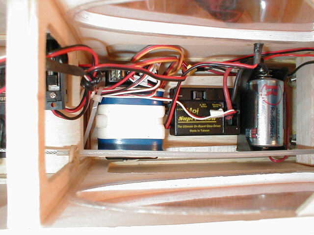

Unfortunately, the ASP .52 I first used in my Rascal did not like to
idle too well inverted. I then installed this MPI glow driver, but I
got some radio glitches with it. Went with a OS .52 and no more
problems. I also like using cable to the throttle instead of that
weird bend you have to put on a wire. Hey khlash99, are you
flying out of Bandera field there in S.A? I flew there as a guest
last month and talk about a short approach! I almost got into the
telephone lines at the west end!! Good luck with yours, and post
some pics.
