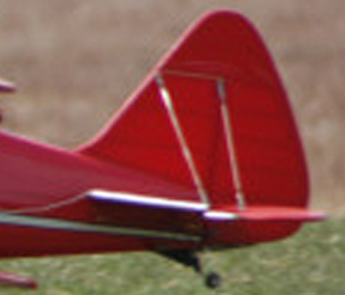

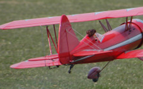

I have the WACO bipe by them, it uses solid wires with clevis' for the tails flying wires. The stab and rudder a probably predrilled then covered over, check for the holes. If it's like the bipe you should hace little metal tabs with two holes in them, you put a bolt through the big hole in the tab, through the stab or vertical fin, then through another tab, you lock tight a nut on there. once you get the tabs on the stabs and vertical fin you put the bracing 'wire' between them.

THe hardware for these tailwires should consist of 8 threaded steel clevices and four steel rods with threads on the ends. You attach the brackets as you already did, then measure and cut the rods so that they are the proper length to go from one bracket to the next with the threaded steel clevice clamping on to each bracket. I can e-mail you pictures if you want. Just PM me your e-mail address.
