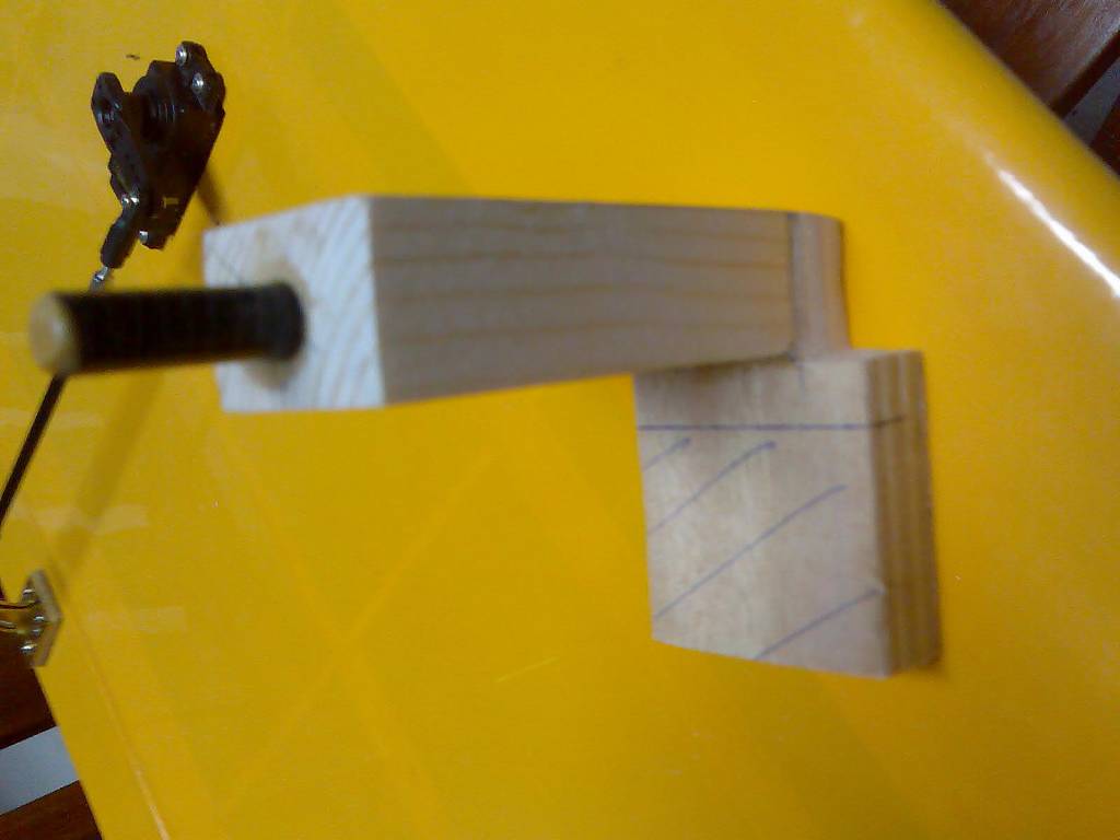

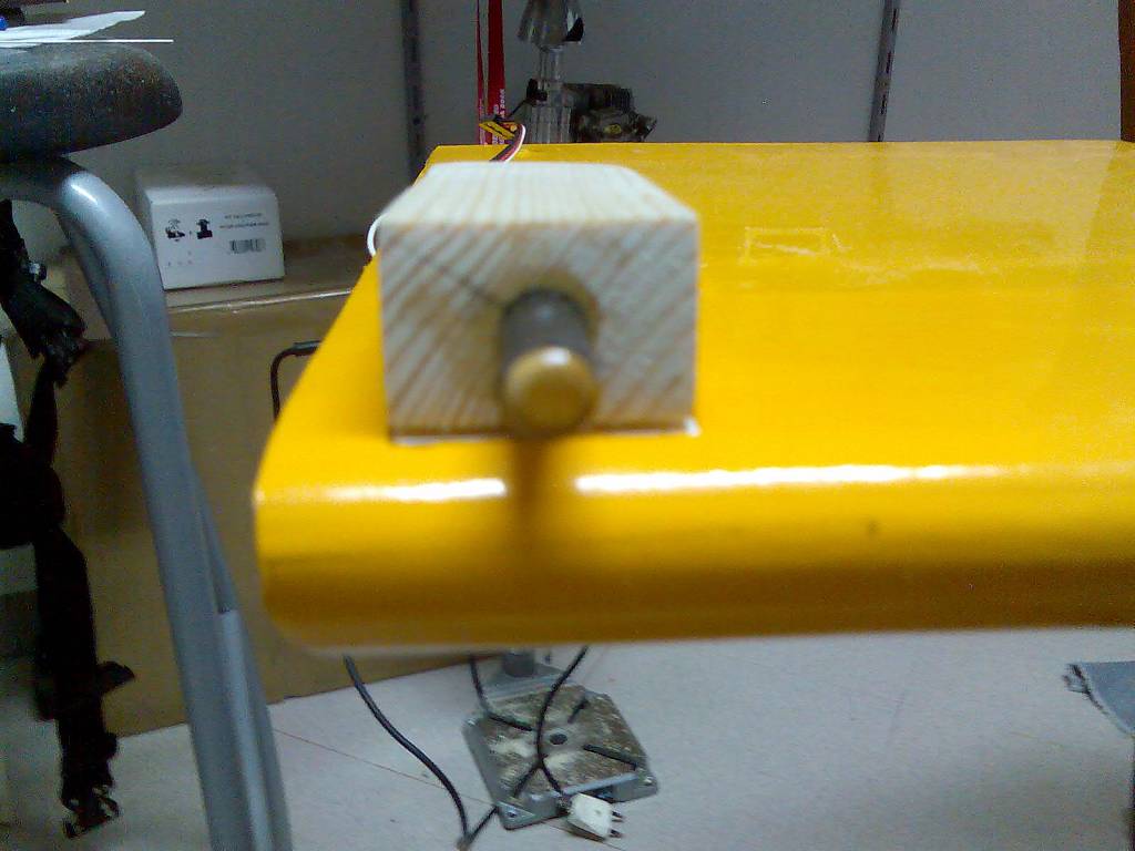

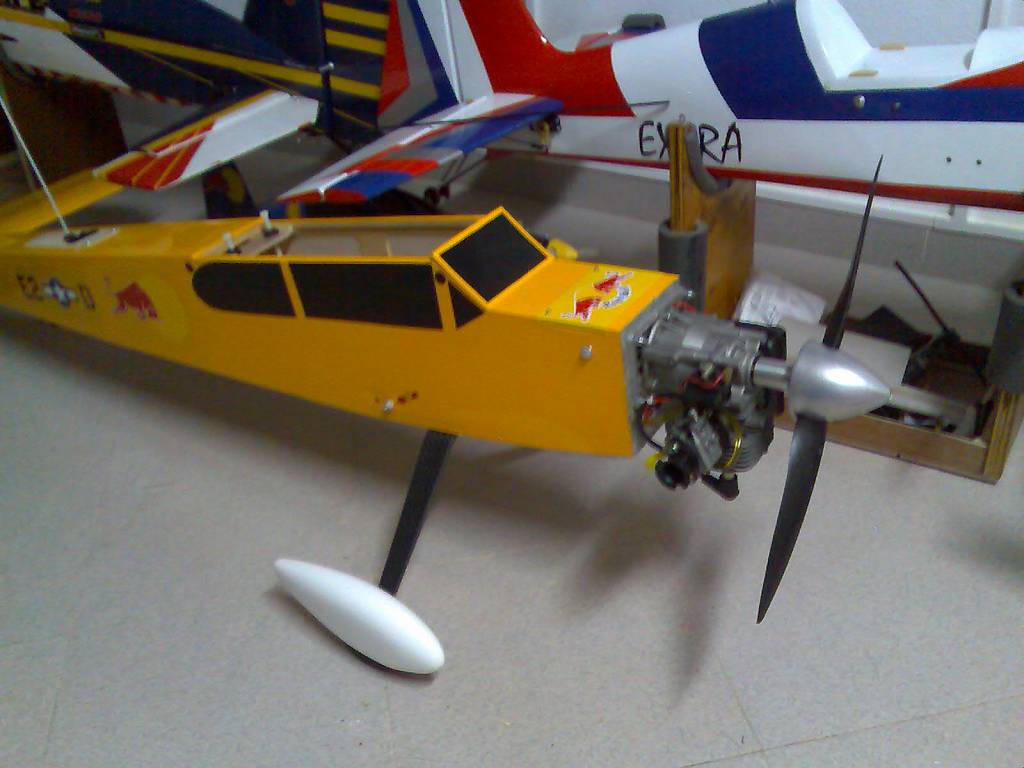

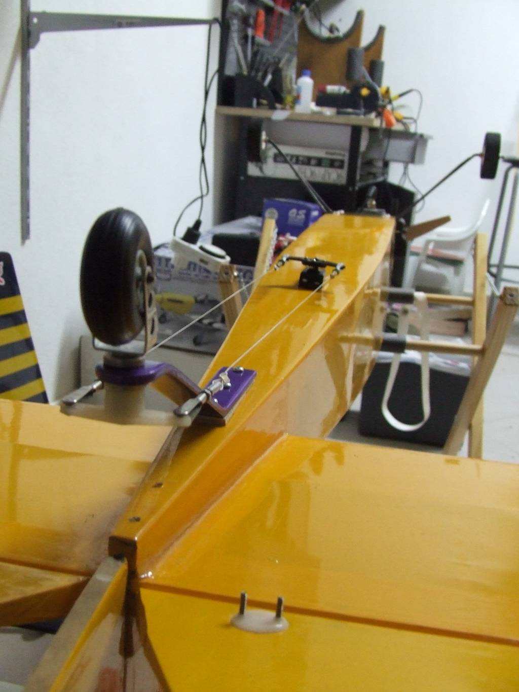

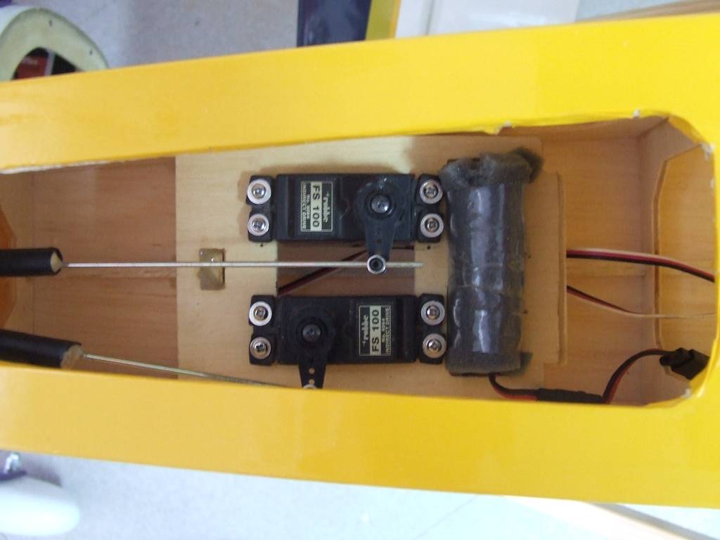

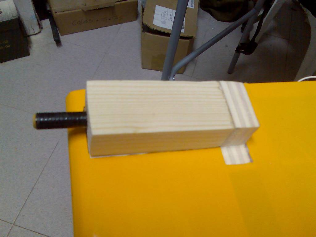

Hello to all from Portugal, i have buy this Senior Telemaster and i would like to show some mods that i have made in order to fly it with a Zenoha 26cc gas engine. So i hope you dont mind! I would loved to find this first because there are a very good ideas on this abaut the wings etc. So see the pictures. I have put some flaps and a new rear landing gear with a pull-pull sistem. The main gear also changed with a carbon one from Carbon Copy in UK and weel spats also. On-off switch on chanel 5 (mandatory for gas engines) and all the servos and batterys in the rear were i have build a hatch for it with the antena in the vertical position. I have made this system to secure the wings in the front of the fuselage with two pieces of hard wood (i have seen this in a forum) and in the bach with two bolts. Carbon rods on all the wings servo, and a 500ml fuel tank in the back of the fuselage bay. I would love to find a cowl to fit on this but so far nothing. So its ready for is first flight as soon as the weather gets better in Europe!!!
