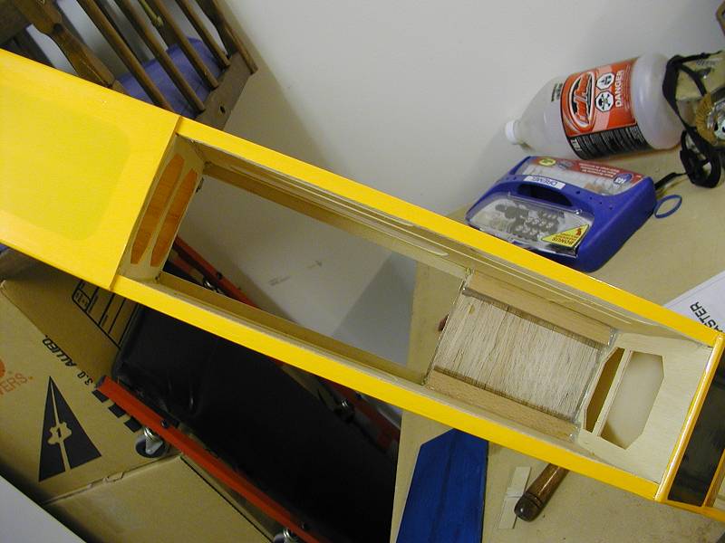

Got some time to work on the bird last night and today. I decided to mount the servos in the tail which required some minor modifications and beefing of the tail. I used two small pieces of balsa the same thickness as the sides to frame in the servo holes and allow me to fold over the covering. I then reinforced the inner top and bottom with some light ply running between the last two formers to give the servo screws something to bite to. I think I must be crazy for trying new wing mount designs considering how the last Telemaster died. I carefully cut out the forward part of the inner wing rib and removed it. I used this as a template and cut a new rib with an extension out of solid oak 1/2!QUOT! thick. I'm going to use the original forward rib and sandwich both together along with a 6 or 7!QUOT! 3/4 dowel that will help distribute the load over several ribs. I surely hope this will be strong enough to hold the forward half of the wing on. I'm going to use the struts also so this thing should be bullet proof. My bomb bay door is going to be more simple then the last one and it's only going to be a single door. I didn't get much done on this part but did start to frame it in with 1/4!QUOT! square hardwood. I hope to get more done this week after work.

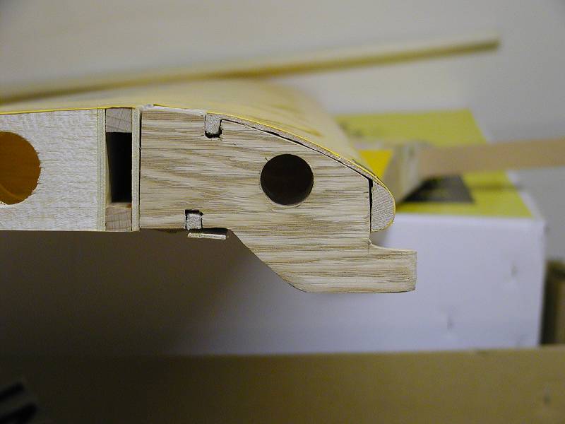

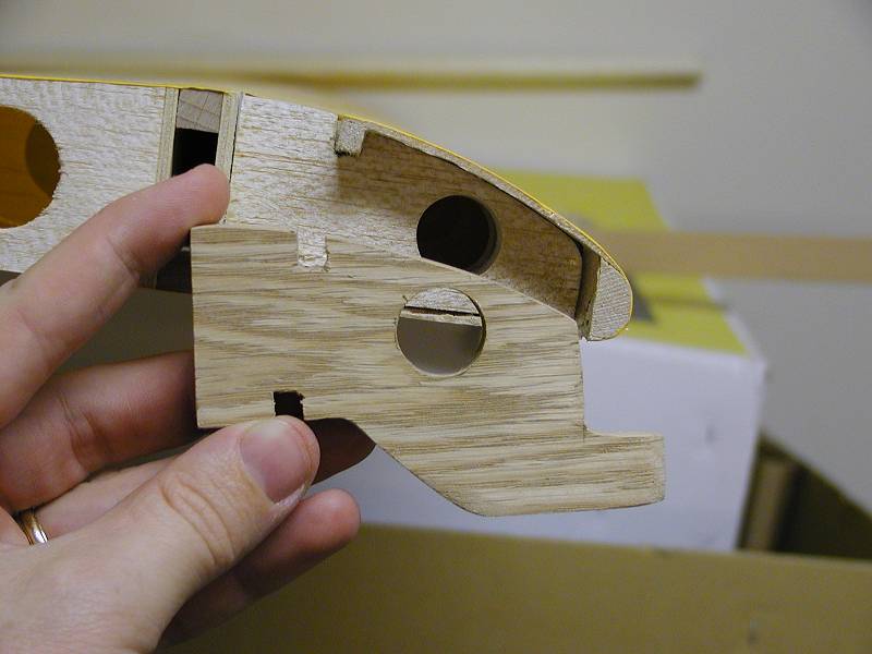

I got some time this weekend to work on the TM. I'm coming along nicely with it. I got the wing mount figured out and it fits well. I still have to epoxy everything in but I will do that last. I got the bomb bay roughed in, tail surfaces and servos mounted and I made a new rudder. I still have a few nights work to do but the first step is to clean up my mess. I seem to have lost one of the two blind nuts I bought for the wing mount.

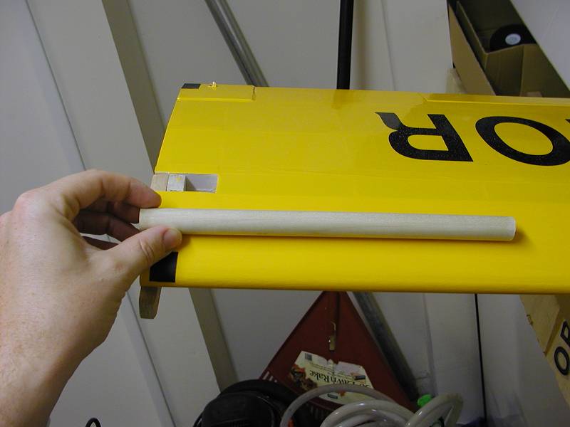

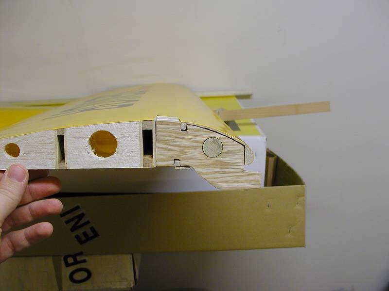

More progress tonight. I got the port half of the forward wing mount done and epoxied. I would have done both half's but I only have one large clamp. As you can see in the pictures I used the original rib as a doubler. I drilled and sanded a 3/4!QUOT! hole to accept a dowel that runs to the 4th rib. I wanted to add the dowel to help distribute the load better. With this set up both forward wing half's would have to tear away for the wing mount to fail. I also got some more work in on the rudder. One thing I didn't like about the hardware included in the kit is the tail wheel mount. I'm not sure why but the didn't install some kind of wheel collar to prevent the forces and bumps being absorbed by the rudder and hinges. I unbent the wire at the top and slid a collar that I will tighten just under the bracket. I'm not sure how much I will get done the rest of the week. Saturday is a big electric event and Sunday is RCX
