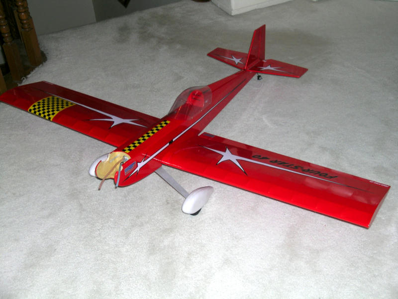

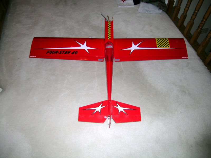

I have just completed a 4 star 40 arf and have no mods done to it. Well its almost complete just have to mount teh engine but everything else is done other than that. My pervious plane was a nexstar so this is goign to be a lot of fun.Please tell me what u think i have plenty of pictures. I order a scale piolet from sig that just hasnt arrived yet (on backorder). srry its a llittle big

Nice. A buddy of mine just finished his too. He's installing an OS .50 on his. Should rock n roll with that engine.
Good luck with yours,,,,,

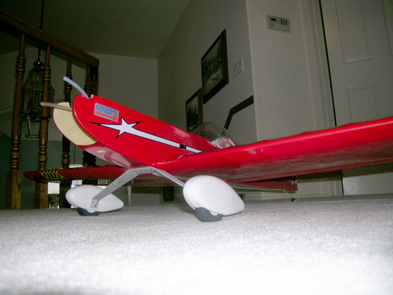

Looks great ! I have read so much about this plane, and all of it good. Did those wheel pants come with the kit ? I like the look it adds to the plane. That cockpit just begs for a pilot [8D]

Yeah, do the ARF's come with the wheelpants?

I thought something looked different. I had a 4* 60 that I flew for a few years. Great plane.
The only thing I would change... get it in the air.
Oh, what's different... the stars are on upside down. But it's yours so it doesn't matter.
Have fun with it.

Beef up the fuse right behind the wing area a bit. The like to break there with even one hard landing. If yours came with metal landing gear screws, go with 1/4-20 nylon bolts. I tapped threads for that right into the wood block. (made it a little thicker on the inside though)
I maxed out the throw on rudder and elevator on mine, and it will do awsome flat spins now! It will hover nicely and has absolutely unlimited vertical with an APC 12x4 prop/magnum .46 engine.

thanks, the arf does come with wheel pants they are very easy to install to.

I fly off of grass so I put slightly larger wheels on, also to clear the 12" prop. Don't know if the pants would fit..... less drag with the pants though I guess.
