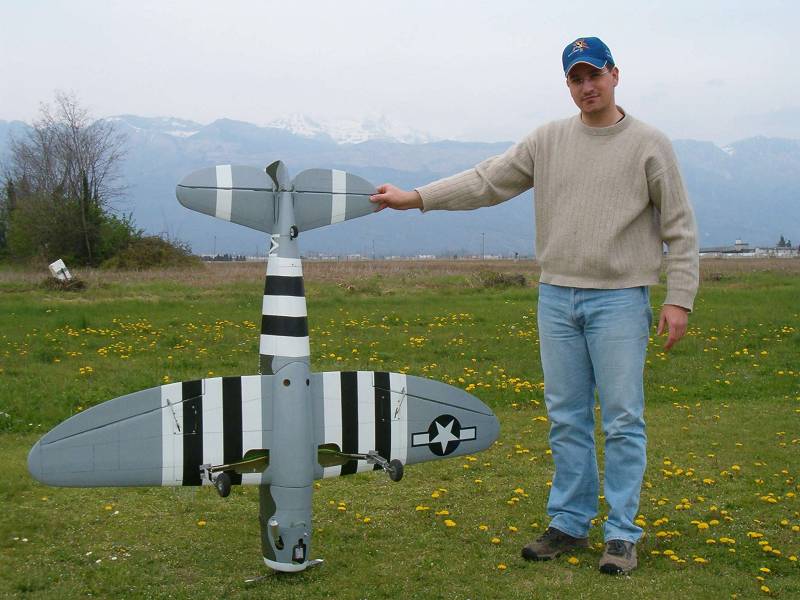

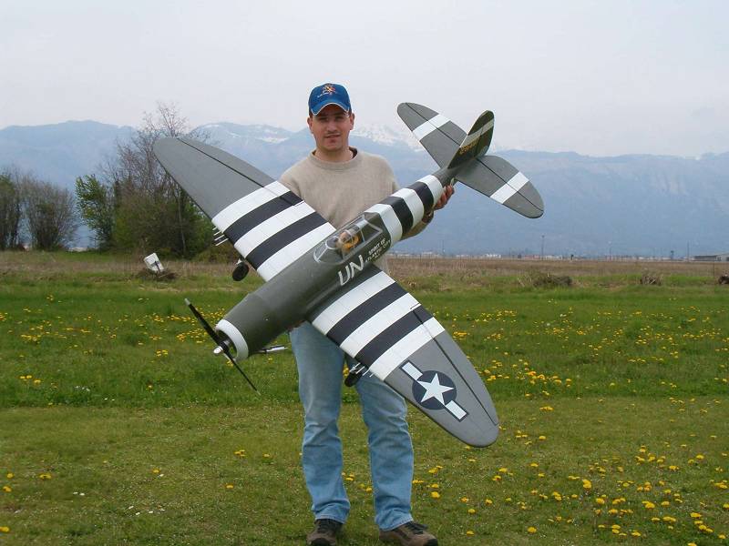

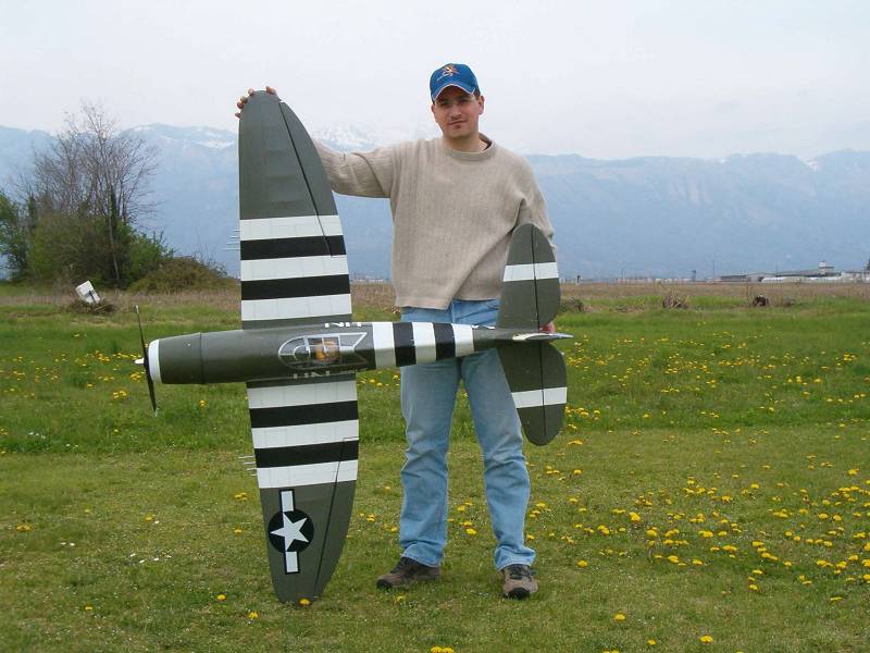

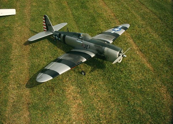

2 days ago, she tokk off from our grass runway.
she flies like a dream. She need only some time to understand her flight.

That's good to hear, Alessandro. Nice pictures, too. Will you get some in-flight photos to post?

Beautiful Thunderbolt Alessandro 78 ! Congratulations on the maiden flight.

Looks nice. Are those the stock gun barrels that came with the plane? Which engine did you go with?
You sure that's the Modeltech ARF. It looks a little different.

Nice job Alessandro,
Looks good, my favorite prop fighter.

That is just about the nicest Modeltech P-47 I have ever seen! [sm=thumbup.gif]

belive me, it is the modeltech P-47 ... with a lot of mod.
the gun barrel are not from the box, because the vacuform ones looks not so good. I replaced with the plactic guide of a pushrod set, and then silver painted.
the engine is a magnum 1.20 4s. the maiden and the second flight were done with a 16x8, but with that it is not fast . probably with a 15 apc may be better.
the wing looks different because I cutted a "like" scale wheels bay, and I removed the covering and used monokote to reproduce a museum warbirds. the b&w stripes come from selfadesive matt pvc.
there are another pair of place with construction picture here and there.
there are no in flight picture yet, because I was so excited for the first take off, that I forgot to take that. next time.
on last landing, she soffered a little damage on gear rails due to my bad landing: too slow and not "soft" enought, but I already repaired it and she is ready to fly again.

You did a great job on the mods. I really like the gun barrels and the color scheme does look more realistic then the original scheme Modeltech had.

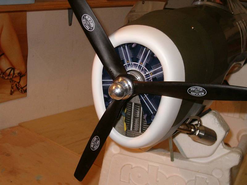

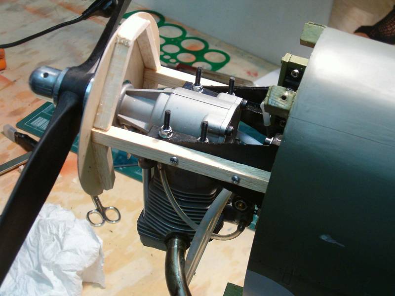

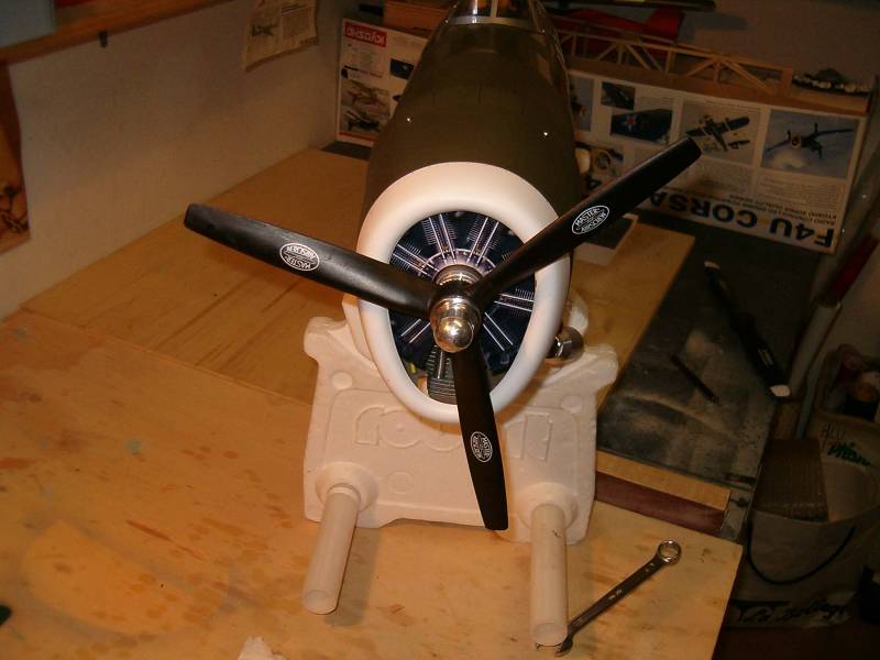

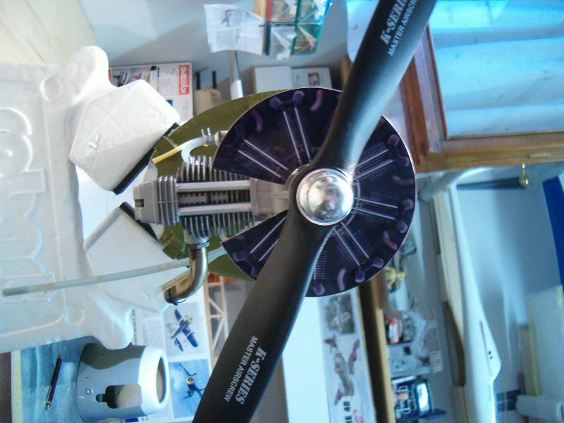

here are the picture of an improvment for scale apparence: I putted a dummy radial engine in front of the cowl. It is supported by 4 screw, so I can remove it if necessary. I found the image of Wasp engine here:
http://www.rcgroups.com/forums/showt...&page=27&pp=15
now I need to fuelproof it

The radial pic looks good. Should help with cooling the engine also. Keep up the good work.

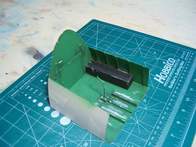

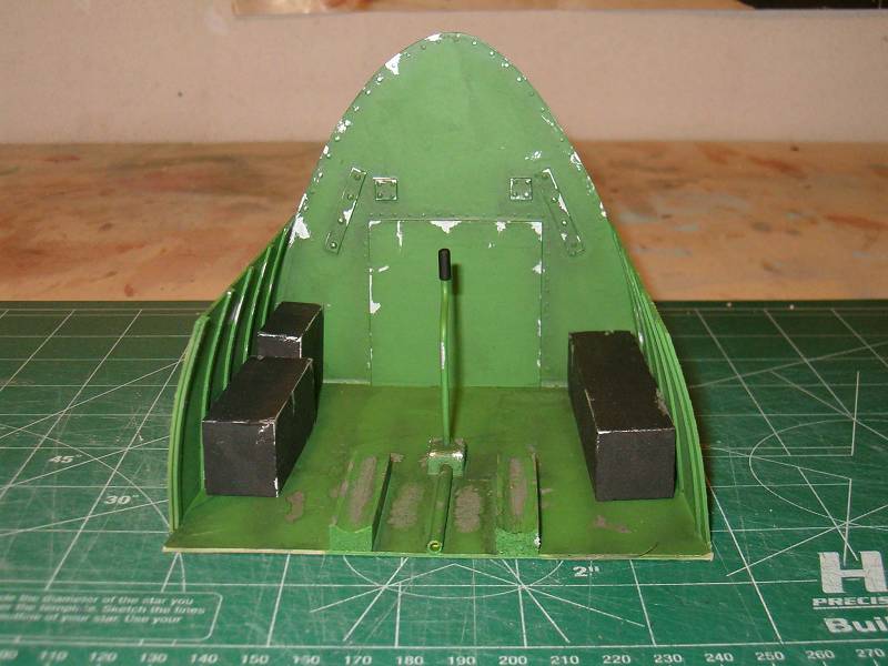

these are the preview picture of one of my current proyect: a Kyosho corsair with some scale details. I started from the "office"
