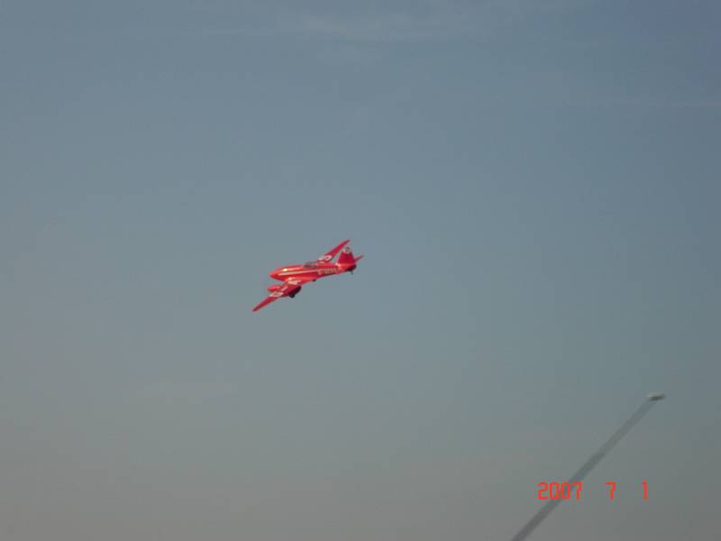

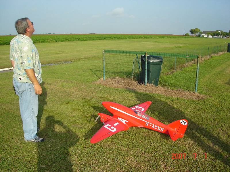

We test flew a friends last weekend, with a pair of Magnum .91FSs. maybe just a "shade" overpowered, but it flys real nice. Some stall tests indicated a "really nasty" stall break. You better have altitude when you stall test it. A little upward reflex in the ailerons softened the stall, but it's still pretty nasty. Fly really fast with the .91s, but not really overpowered too bad. Jumps into the air after about 20' if you don't hold it on the ground. Landings were a thing of beauty. At about a foot of altitude, just released the elevator and it settles down to smooth wheel landing. He is using Spring Air retracts with the ASM struts.

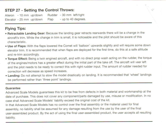

I am in the process of finishing mine up and my manual has come up missing. Does anyone have the recommended factory throwes and cg.

Aileron - 10 mm up/down
Elevator - 25 mm up/down
Rudder - 30 mm up/down
Flap - up to 40 degrees
Those all seem to be real low rates but that is what the manual says.
CG - The CG for the comet is 115mm from the leading edge measured at the fuselage side. Note: if the optional retractable landing gear is fitted, balance the model with the landing gear retracted.
What if any modifcations did you make to the tail section's setup?
Looking foward to hearing about your first flight!
