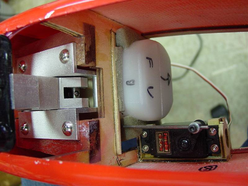

Next up is the tight fit of the laser cut parts. These are the servo mounts that go inside the nacelles. I am actually happy with these parts.

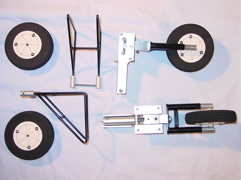

Here's the landing gear. It's kind of hard to see in this pic, but you'll notice how the wheel isn't aligned with the rails. Also note the ridgid structure and farm- quality welds.

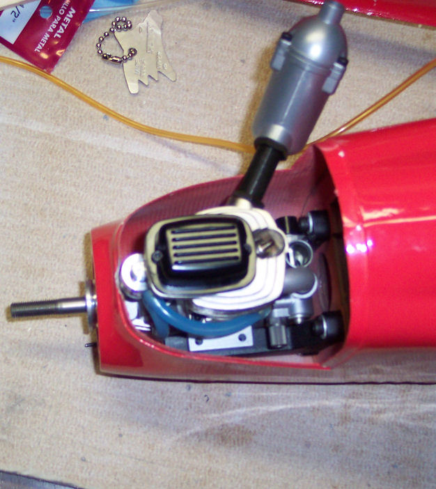

I chose the YS 63 for mine and it is 97.5mm from back of the motor to the prop hub. It is a bit hard to see in the picture attached but there is about 1/8" or less from the back of the motor (throttle arm) to the engine mount bolts and that leaves about 1/8-3/16 sticking out from the nose ring.
A Du-Bro spinner that is set back will eliminate most of the gap in the front.

That's a lot of power for this bird. I have a YS 53 and flew it in a 70" Tigermoth with authority.
One word of caution on this DH88. The retracts offered with this plane look great although way stronger than the structure they mount into and the offered dual struts appear to be deadly. There is no way to stop them from rotating left and right. They are attached by means of one shaft held into the retract with two Allen ( grub ) screws. Then the strut is held to the shaft by one nut and an aluminum spacer. If the nut is tightened too much it will overpower the the grub screws and pull the shaft out. The springs and the slides of the struts binds when pressure is applied. The same pressure that landing loads could cause! This plane will not be able to sustain too much impact . I'm strongly considering going with a single robart strut. Scale looks be damned. It's better in my mind than taking a chance at destroying the plane. I've still not finished mine and I have the first one that came into the Hobby People in my area.
I installed a pair of older OS 40fsr's While they won't be nearly as powerful as your 63's they should be adequate. I had them in a 60 size Super Sportster I had converted to a twin with nosewhell retracts. It was fairly fast! Sold the airframe but kept those engines!
I think with those YS63s your going to melt that nose lite. WOW
That's a lot of power for this bird. I have a YS 53 and flew it in a 70" Tigermoth with authority.One word of caution on this DH88. The retracts offered with this plane look great although way stronger than the structure they mount into and the offered dual struts appear to be deadly. There is no way to stop them from rotating left and right. They are attached by means of one shaft held into the retract with two Allen ( grub ) screws. Then the strut is held to the shaft by one nut and an aluminum spacer. If the nut is tightened too much it will overpower the the grub screws and pull the shaft out. The springs and the slides of the struts binds when pressure is applied. The same pressure that landing loads could cause! This plane will not be able to sustain too much impact . I'm strongly considering going with a single robart strut. Scale looks be damned. It's better in my mind than taking a chance at destroying the plane. I've still not finished mine and I have the first one that came into the Hobby People in my area.

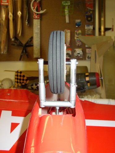

A two piece tailwheel assembly makes life a lot easier. Needed a ply plate to support the load from the pull-pul wires.

I have mine in my garage. I just got the suggested Landing gear and scale gear. I think Robart makes them(?)
The Friggin landing gear cost me a small fortune at almost 250 bucks
